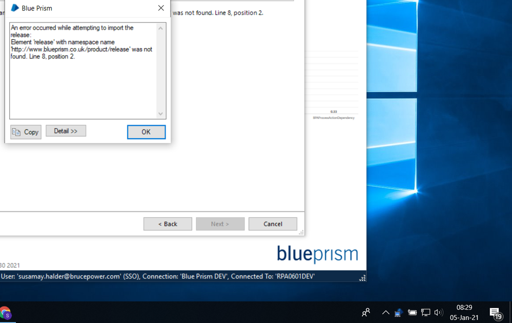

I tried importing the bprelease file however its gives the below error
28120.pngAny thoughts?

What version of Blue Prism are you running?
Eric
I am using blue prism version 6. Is that impeding the extraction process?

That could be the issue. I imagine this release was created in 6.8 or 6.9. The makeup of the bprelease file changed a bit in 6.6.
Let me work a little magic on the file shortly, and then update it on GitHub. I'll let you know as soon as it's ready.

There's a new version of the .bprelease file available on the GitHub page. This should work for you.
@Charles
I did tried with the new release file you have shared on github page but the error remains.

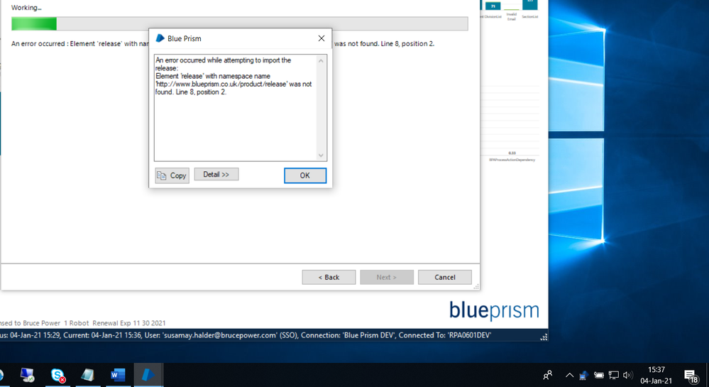

Try opening the .bprelease file with a text editor (ex. Notepad). Do you see HTML tags in the file or just XML?
@ewilson
Hi Eric,
I did tried saving the file in notepad. Do you mind taking a look? it there in attachment.
