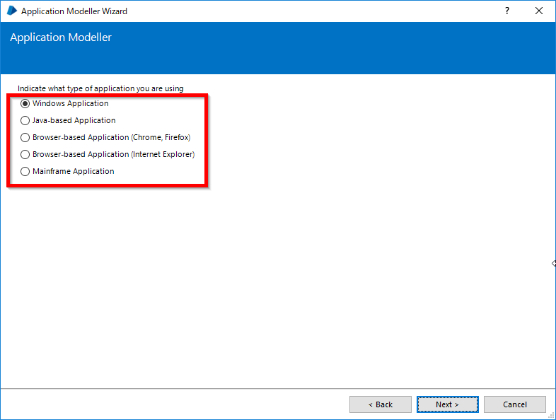

Did you select any one of types of application in the following on Application Modeler Wizard?
  • Browser-based Applications (Chrome/Firefox) - which need Chrome/Firefox Extensions
  • Browser-based Applications (Internet Explorer)
If so, did you spy the inside Web Page area, other than outer Window Application area?
HTML mode will only recognize the HTML elements within the web app, nothing outside.
Hope this helps.

Yes i checked by launching both (IE/Chrome browser) from Application Modeler Wizard. After launching the application when i try to spy html elements, It doesn't show HTML mode for the same.

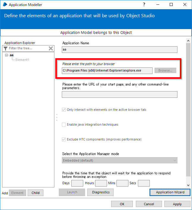

Did you set the correct path of IE process such as "‪C:\Program Files (x86)\Internet Explorer\iexplore.exe"?
Tetsuji Junicho
Manager of RPA Practice Grp.
Accenture Japan
Asia/Tokyo
Yes path is correct.
