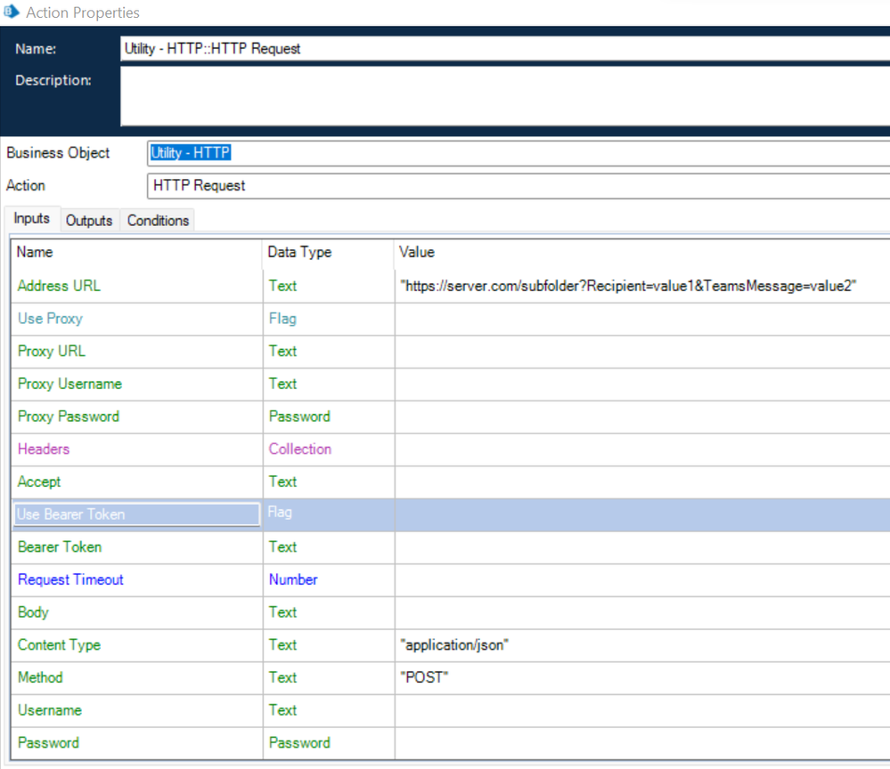

Can you try like below. I am assuming you only need to pass URL parameters and the Body is blank.
The URL params can be set in the Address URL as shown in the screenshot.
