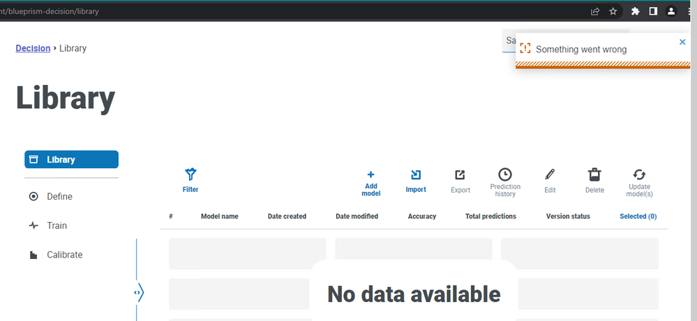

I'm too facing this error. It does not let Import Decision model neither let me create a new model.

This is most likely an issue with one of the Web Apps not starting correctly. You can try restarting the Web Server or the application pools, and then relaunching Hub.
If this does not work, it's worth taking a look at the logs (by default at C:\Program Files (x86)\Blue Prism\Hub\Logs_Hub), and contacting support@blueprism.com.

Hi Tejaskumar
Your issue is different and specifically relates to Decision. You can check the logs to assess the issue (default location is C:\Program Files (x86)\Blue Prism\Hub\Logs_Hub) and there are some common troubleshooting tips here.
I would also check that:
Once complete, restart hub completely and check again.
If this doesn't work, this will be one for support@blueprism.com.

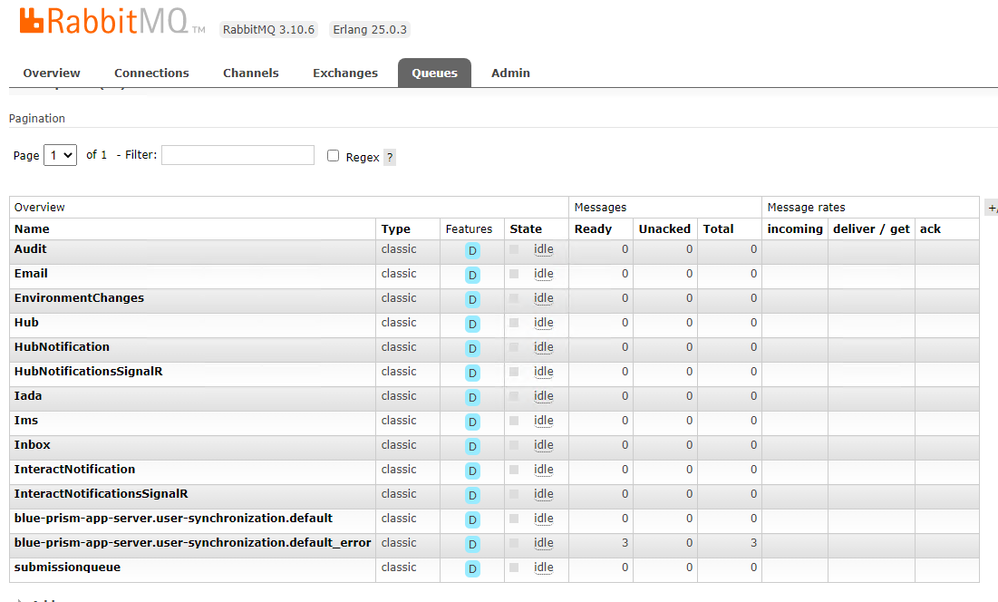

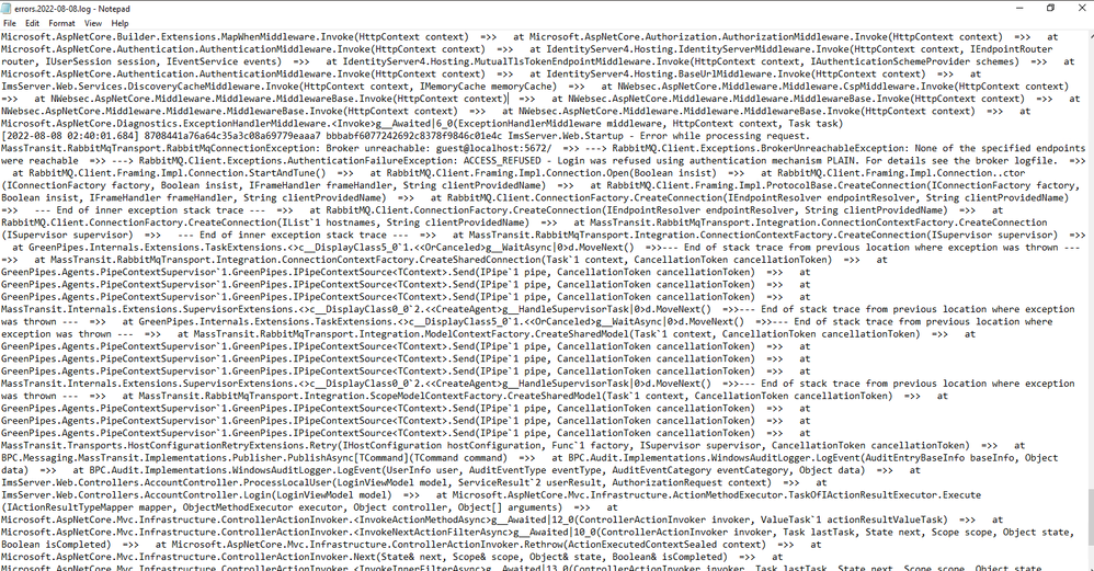

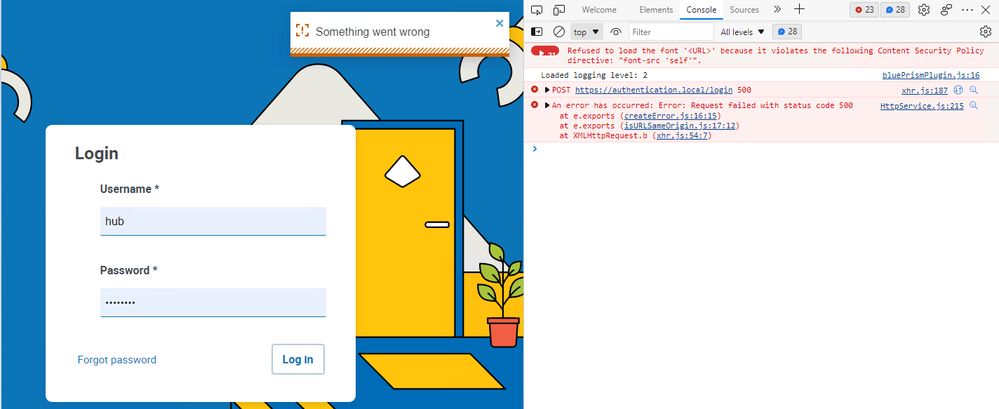

Hi @Joe Farr
I've updated my Hub to the latest version 4.6 and now I'm not able to login to Auth Server and it keeps throwing "Something Went Wrong"
I checked Logs_Hub folder but it empty.
I tried to explore many troubleshoot options but nothing seems to be working for me so far.
Before the Hub 4.6 update, I was able to login into Auth server and so Hub and BP were accessible.​
But in Auth server log I do see this item.
I doubt something is off with RabbitMQ that it is not able to connect and hence Auth Server, Hub, BP nothing is reachable.
But I'm not sure so need help.
