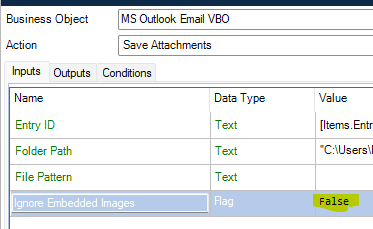

Hello @ChristopherBerr  - image001.png is coming to due embedded image like signature and company logo.
This has been in-corporate in latest VBO available on DX 2-3 days before by @ewilson. Please use the latest MS outlook VBO from dx.
https://digitalexchange.blueprism.com/dx/entry/3439/solution/ms-outlook-vbo
Flag action in save attachments will control the saving of these kind of attachment. I  have tested it and working fine for me.
30772.png​​
