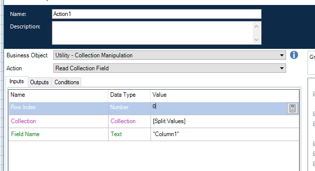

@Michal Szumskil thanks, but I cannot read the rest of my date items. I am able to only read the first value so in this case number 11. I cannot read the day nor the month. I have only 1 column in my collection and this "Read Collection Field" from "Utility - Collection Manipulation" reads only the first value. Please have a look on my screenshot

Hi Patryk,
You have to define row index and field name to get specific collection "cell":
0 - means first row, 1 means second row and so on. In Field Name just put name of the column that was created by "Split" action. For me it worked just fine but You need to use this action 3 times for each part of date.

It works now. I've changed the Row Index value. My code is huge now. I will try to modify and improve it. Thank you so much for your help.
