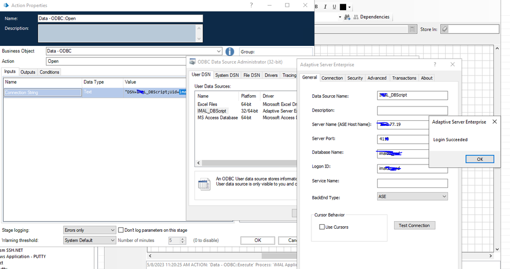

08-05-23 09:30 AM
Below Connection String for Sybase, and both open connection & execute actions are working.
"DSN=IMAL_DBScript;Uid=username;Pwd=pass;" where DSN name is the odbc connection name.
