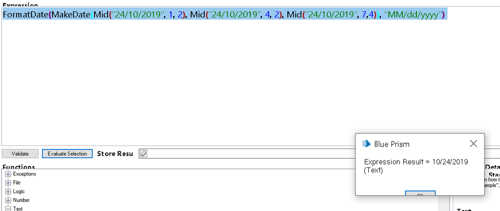

vivek.kumar.goel
Assuming:
1- Input format is of String
2- The input format is fixed to be "dd/mm/yyyy"
Solution:
FormatDate(MakeDate(Mid("24/10/2019", 1, 2), Mid("24/10/2019", 4, 2), Mid("24/10/2019", 7,4)), "MM/dd/yyyy")

Hi prashant,
Remember, "Format Date" only works if your input is  a "DateTime" . If your input is a string, then essentially you will have to convert the string to date time using string manipulation and then use format date which is similar to the one liner I provided in my earlier reply.
But if your input is already in datetime, then your solution will work perfectly. Kudos
