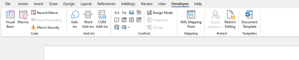

Coming to your second use case, for working with checkboxes first I will explain you a bit about the type of control that it is before proceeding with the solution. Checkboxes in Word documents are usually of the type Form Controls which you will be able to find from the "Developer" ribbon on your Word Application as shown below:
First to automate any such use case where a lot of external components are included some standardization is required such as if we have a table then the table name ideally should be available otherwise we have to proceed with indices where the problem is that tomorrow if the position of the table changes then our index also won't work.
Similarly in case of checkboxes one needs to have them standardized as a best practice. For identifying checkboxes we have an identifier element called as "Tag" that is associated with them. You can check if your checkbox elements also have this tag value or not first by following the below steps:
- First select the checkbox whose tag name you want to check, (like in my case I have selected the checkbox - "Yes") and then click on the "Properties" button under the Controls section of your Developer Ribbon on top.
- Check if the tag name field is provided or not first in such a case as you can see from below:
If the tag name is provided for all such controls it will be easier to implement the below solution otherwise you need to identify the correct sequence indices of all such checkboxes by hit and trial method using different index values in the solution I provide you.

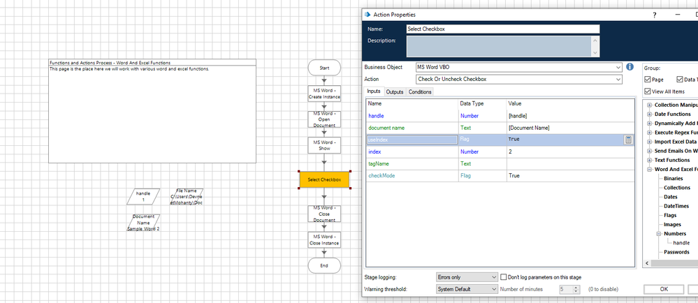

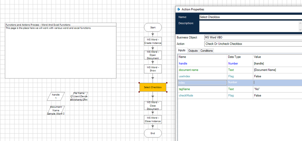

Solution Implementation:
In order to implement the solution, first extend the "MS Word VBO" by creating a separate action within it and you can call it as "Check Or Uncheck Checkbox". This action will be having the following input parameters:
- handle (Number) : The data item having the handle value in the instance dictionary that needs to be queried. (This you can get from Create Instance action)
- document Name (Text) : The document name of the current workbook which the Blur Prism bot is operating on. (This you can get from Open Workbook action)
- use Index (Flag) : The flag value indicating if the checkbox needs to be located using index or tag name. If the value is True, index based search will be performed and the flag is False, then tag name based search will be performed.
- index (Number) : The index value for the checkbox control on which the action needs to be performed. (The index values start from 1)
NOTE: This value will be only used if the use Index data item value is True. - tag Name (Text) : The tag name associated with the checkbox control on which the action needs to be performed.
NOTE: This value will be only used if the use Index data item value is False. - check Mode (Flag) : The flag value indicating if the selected checkbox needs to be checked or unchecked. If the flag value is True, then the checkbox will be marked as selected otherwise it will be deselected.
Refer to the below workflow for more information:
Now, add a custom code stage with the following Input parameters and the code as shown below. No output parameters are required:
Code:Const wdContentControlCheckBox = 8
Dim d As Object = GetDocument(handle,document_name)
Dim success As Boolean = False
If use_index = False Then
For Each ctrl In d.ContentControls
If ctrl.Type = wdContentControlCheckBox And ctrl.Tag = tag_name Then
ctrl.Checked = check_mode
success = True
End If
Next
If Not success Then
Throw New Exception("No form control of checkbox type was found with the supplied tag name")
End If
Else
If d.ContentControls(index).Type = wdContentControlCheckBox Then
d.ContentControls(index).Checked = check_mode
Else
Throw New Exception("The form control located at the supplied index is not of checkbox type")
End If
End If
You can publish this action and run the same from Process Studio to check your results.
Some of the test results are shown below:
Scenario 1: For the input file having both the checkboxes as unselected, using index based search for selecting "No" checkbox (index=2)
Result of the action is:
Scenario 2: For the input file having the "No" checkboxes as selected, using tag name based search for deselecting "No" checkbox (tag Name= "No")

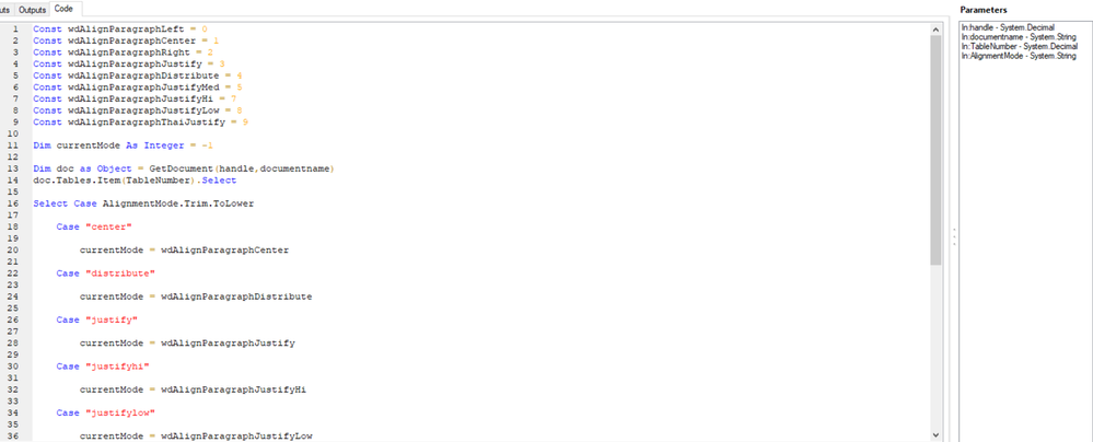

Glad to know your second issue got resolved 😊 Coming to your first issue, I suspect it might be some weird behavior with you internal table formatting for that word document while entering the value. However, one workaround that I can suggest is to change the formatting of the entire table itself to "Center" as in your case by invoking it explicitly using some code. You can implement the solution that I have stated below once you have set up all the cell values in your table.
In order to achieve this, we can extend the "MS Word VBO" by creating a separate action within it and you can call it as "Align Table". This action will be having the following input parameters:
- Table Number (Number) : The table element index used in the current workbook to identify the table. (This value will be the same that you have been using as a part of the Set Table Cell Value action)
- Alignment Mode (Text) : The alignment mode according to which the table element needs to be aligned. (The possible values are: 'center', 'distribute', 'justify', 'justifyhi', 'justifylow', 'justifymed', 'left', 'right' or 'justifythai')
Code:
Const wdAlignParagraphLeft = 0
Const wdAlignParagraphCenter = 1
Const wdAlignParagraphRight = 2
Const wdAlignParagraphJustify = 3
Const wdAlignParagraphDistribute = 4
Const wdAlignParagraphJustifyMed = 5
Const wdAlignParagraphJustifyHi = 7
Const wdAlignParagraphJustifyLow = 8
Const wdAlignParagraphThaiJustify = 9
Dim currentMode As Integer = -1
Dim doc as Object = GetDocument(handle,documentname)
doc.Tables.Item(TableNumber).Select
Select Case AlignmentMode.Trim.ToLower
Case "center"
currentMode = wdAlignParagraphCenter
Case "distribute"
currentMode = wdAlignParagraphDistribute
Case "justify"
currentMode = wdAlignParagraphJustify
Case "justifyhi"
currentMode = wdAlignParagraphJustifyHi
Case "justifylow"
currentMode = wdAlignParagraphJustifyLow
Case "justifymed"
currentMode = wdAlignParagraphJustifyMed
Case "left"
currentMode = wdAlignParagraphLeft
Case "right"
currentMode = wdAlignParagraphRight
Case "justifythai"
currentMode = wdAlignParagraphThaiJustify
Case Else
Throw New Exception("Invalid alignment mode has been supplied")
End Select
doc.ActiveWindow.Selection.ParagraphFormat.Alignment = currentMode
Code:
doc.Tables.Item(TableNumber).Cell(Cell_Y,Cell_X).Range.Select
Case "center"
Case "distribute"
Case "justify"
Case "justifyhi"
Case "justifylow"
Case "justifymed"
Case "left"
Case "right"
Case "justifythai"
Case Else
End Select
