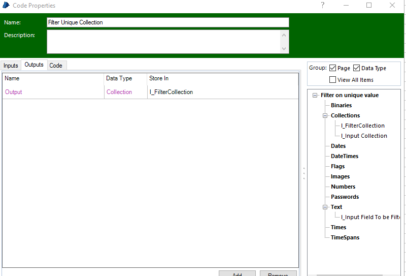

Have you changed the code to options to C# in initialize page? Also make sure the Column name you are passing is correct. But fto make it easy I have attached VBO here. Just import and use it.

H Kumari,
PFB Code it's very easy to use, It is C# code.
DataView view = new DataView(InputColl);
DataTable distinctValues = view.ToTable(true,(Input));
Output = distinctValues;

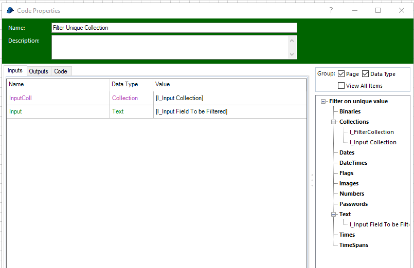

HI Kumari,
The above code is for single input. So if you want multiple inputs then you have to add multiple inputs to your code stage start parameter and  use it in code stage. Also in intialie page of object change the code options to C# by default it will be Visual Basics
DataTable distinctValues = view.ToTable(true,(Input),(inpu1),(input2));

Hi Amlan,
i tried this but one issue i am getting ,actually i am not getting output row ,what you have showed in  second screenshot.
so because of this i am not getting any output collection.
guide me on this!
