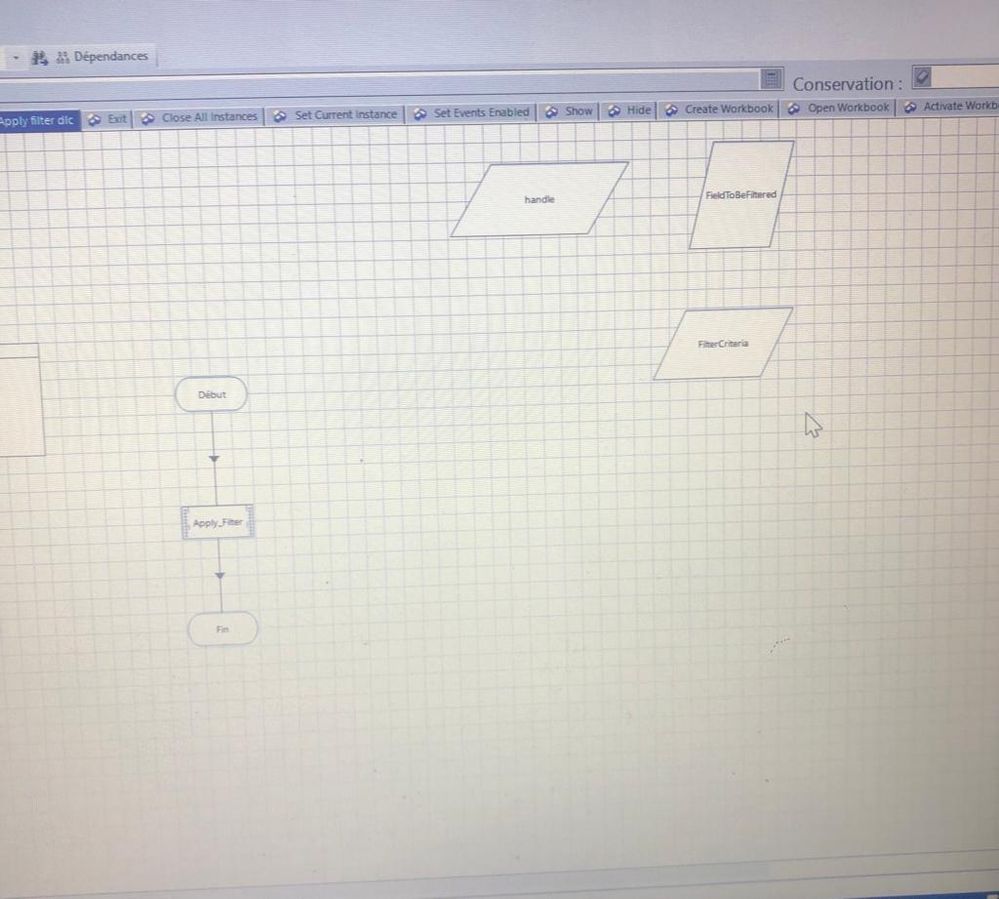

i'm writing my code filter excel , but i have a erro :
internql impossible d'executer la phase de code parceque l'exception a été lancée par la phase de code exception HRESULT : 0x800A03ECbut i think i have not erro in my code

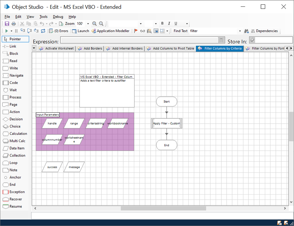

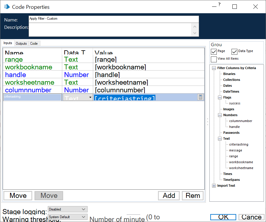

Are you trying to set a filter on an excel file? Is this a code action you have written yourself and are getting an error message? If you share your code we could possibly identify errors in it. I've previously done something similar I've included my code below and hopefully its useful to you and you can make use of it or it will help you resolve the issue in your own code.
Inputs - Handle, range, workbookname, worksheetname, criteriastring, columnumber
Outputs - Success, Message

17-02-22 06:14 PM
Cissoko please see the screenshots below. Hope this helps
