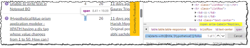

You can always use XPath Expressions (XPath 1.0) in your Web Path/XPath to locate elements that change dynamically. By using a relative element, you can find elements that have no unique attributes from other elements and that may move around the page.
Take for instance your Thread on this community's Thread list. It's very easy to find the subject of the thread but it is not so easy to find the element that holds the number of replies to the thread. There is no unique attributes of the "number of replies" element. But you can zero into it by using the following XPath expression:
(//a[starts-with(@title,'(Hypothetical)')]/following::span[starts-with(@aria-label,'Replies,')])[1]
What the XPath expression does is finds the first anchor element with a title attribute that starts with "(Hypothetical)" and then finds the first span element where the aria-label attribute starts with "Replies" that follows that anchor element.
Blue Prism works beautifully with XPath Expressions and all our developers now use XPath Expressions on every Chrome or Edge project.
The added benefit to using XPath Expressions is that you can easily write them and test them using the DevTools in Chrome and Edge. You can see for yourself by:
  1. opening up this Community Thread list Blue Prism Product
  2. pressing Ctrl-Shift-I in Chrome or Edge
  3. going to the "Elements" tab in DevTools
  4. pressing Ctrl-F
  5. paste the above XPath Expression into the find box
If you keep setting the Threads list to 50 per page you will see that over the next few days that one expression will keep finding that number of replies element until it eventually drops off the top 50.
