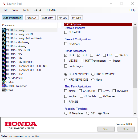

I'm having difficulty attaching to a Windows Application using the Application Modeler in Blue Prism 6.4.2. The application is, as far as I know, a straight-up Windows app with nothing unusual. It's called Launch Pad, written in-house by our company. It's purpose, though this shouldn't be relevant, is to allow the user to select options for and launch our CAD tools.

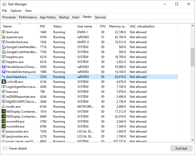

The application is expected to be running (it launches on login), so BP should simply have to attach to it without launching it. Its Windows process name is "launchpad.exe" and Window title is "Launch Pad"

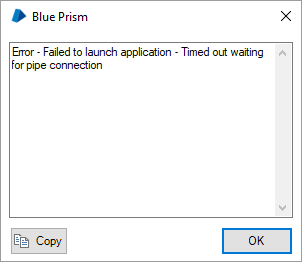

When I try to attach, I get the following error message:
If I add the filename to launch the application, it ignores the running instance and tries to launch a second instance, which shows up in Task Manager as having a status of "Suspended" and I get this error from BP:
I'm at a loss. I've tried with and without the Restrict to non-invasive automation techniques option and with all the different Application Manager modes. Nothing helps.

I've tried all the different Application Manager modes to no effect. I've also tried turning off Restrict to non-invasive. No joy there, either. I also did, in fact, try to attach to it as a Java application. That didn't work at all. Finally, I tried to have BP launch the app itself. Same result as attaching with the application filename specified (app runs, but process comes up as "Suspended" and BP reports "timed out waiting for pipe").

Hi Todd - the 'timed out waiting for pipe' is probably a result of having unchecked 'Restrict to non-invasive' according to this KB article, so best to tick it back on. But regarding the original problem, it might be worth raising a ticket to see if our support team can help.

John: The 'timed out waiting for pipe' error occurs regardless whether the non-invasive option is checked. The launchpad.exe file is not in either Program Files directory. It's on a shared network drive.

Other suggestion is the process name you are using is not correct... even though it looks like it is in session manager. Try attaching with and without the .exe extension in the process name. Try using wild cards at both ends of the name (I've had it before where a process name had a space on the end I could not see - took me hours to figure out why I was having the exact same problem you are now having).
I've also seen other strange things happen like the process name needed to attach Blue Prism using standard .NET code is not the same as the process name displayed in task manager for the process (no idea what that is about - but it is a very rare edge case). I think to solve something like that once I created some code that got all windows processes, looped through them, and got the process name and ID for them all. You could do something similar (internet has code for doing that if you search something like 'get process names and ids .NET') to validate you are attaching to the correct thing.
