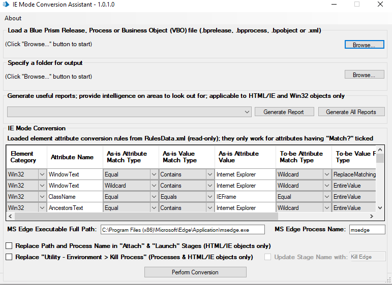

For me - I am not able to see the bottom pane/option for Tool on my org laptop although opening fine in personal system. Need few pointers on what can be done to open .
Tried running as admin , may be resolution issue , i am not sure. how to fix this.

We are aware of instances reported by other customers of the utility not showing the lower section. Please ensure you have your screen resolution height to 1000 pixels or higher. This requirement is now in place in the user guide under the pre-requisite section.
In the next version, we will provide a fix for the issue.

I am also facing same issue.

Although Application modeler conversion tool is working fine , only IE Assistant tool was having issue.

The new version has been submitted to the DX and is currently being reviewed by the DX team. It should be available very soon.

The new version is now on the DX. Please check to see if it works for you.
