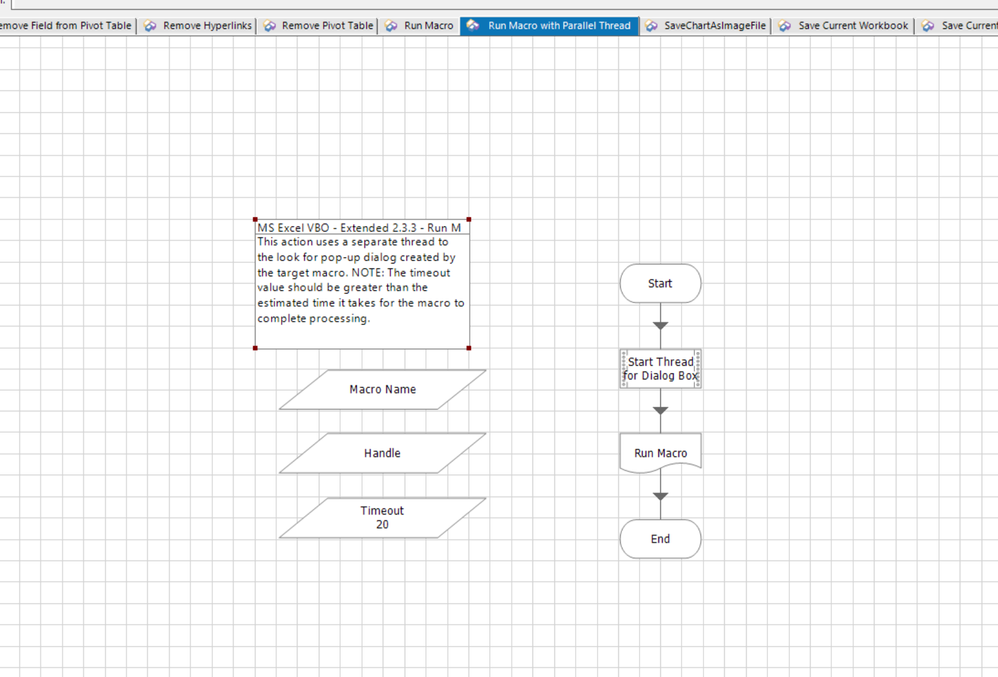

The other thing which you can try is to go with the latest Excel business object at DX Exchange: MS Excel Extended
Here you can use one of the action called as 'Run Macro With Parallel Thread' that basically runs the macro code as a separate thread call instead preventing your bot execution to get halted. Below is the sample action:
