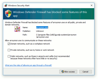

03-04-25 06:39 AM
It turns out that if I press "Cancel" to close the dialog when such a dialog is displayed, communication is blocked by the firewall.
When this happened, I changed the blocking settings and RR worked normally.
