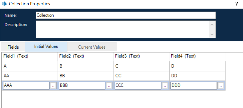

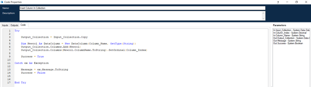

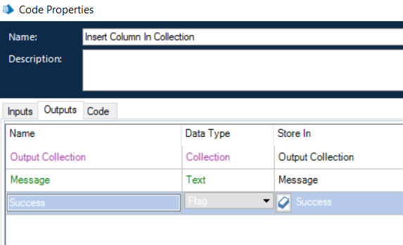

Thanks for reaching out to me 🙂 As per your requirement, I have created a separate code on VB .NET only which you can easily use while extending the Utility - Collection Manipulation VBO. Please follow the below steps:

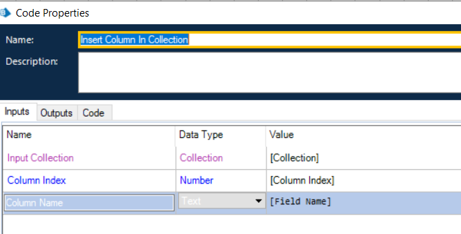

1) Create and action called 'Insert Column In Collection' with the given input parameters for the action: Collection (Collection), Field Name (Text) and Column Index (Number) along with output parameters: Message(Text), Success(Flag) and Output Collection (Collection) as shown below:
2) Add the code stage named Insert Column In Collection with the below parameters:
3) In the Code tab insert the following code:
Try
    Output_Collection = Input_Collection.Copy
    Dim Newcol As DataColumn = New DataColumn(Column_Name, GetType(String))
    Output_Collection.Columns.Add(Newcol)
    Output_Collection.Columns(Newcol.ColumnName.ToString).SetOrdinal(Column_Index)
     Success = True
Catch ex As Exception
    Message = ex.Message.ToString
    Success = False
End Try

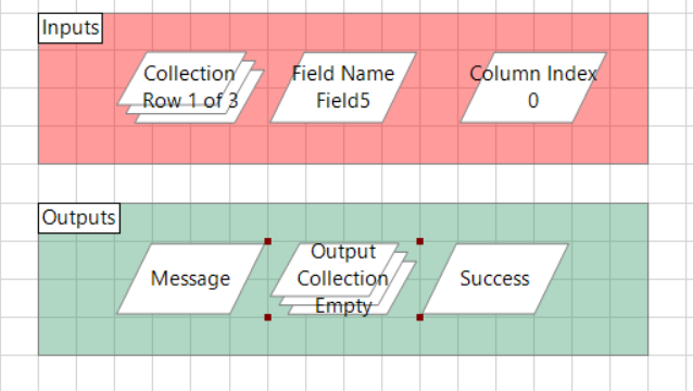

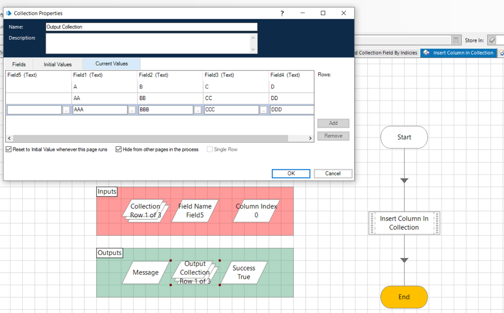

Test Results:
NOTE: Remember the Column Index is valid from 0 to N-1 where N is the number of columns in that collection
Hope it helps you out 🙂
Try
     Success = True
    Success = False
End Try
Test Results:

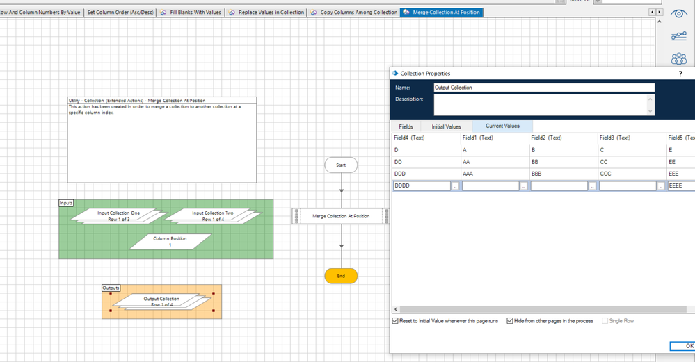

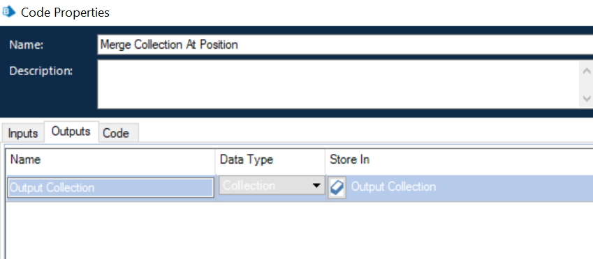

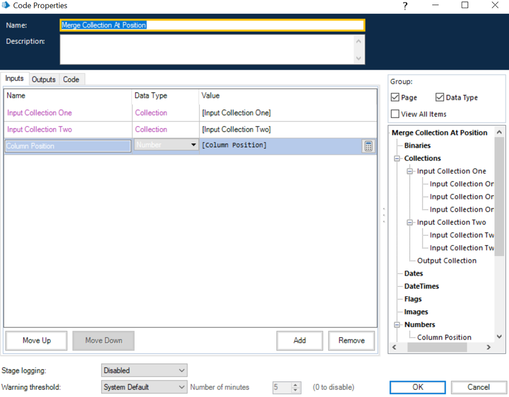

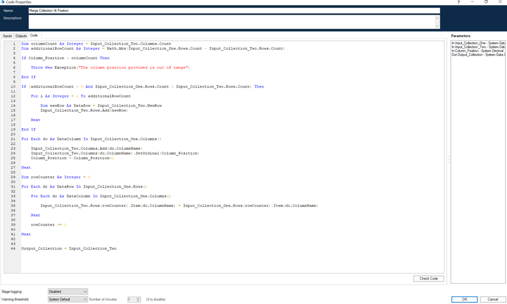

Use Case - II :
Create a new action called 'Merge Collection At Position' by extending the 'Utility - Collection Manipulation' VBO. Add the following input parameters to this action:
- Input Collection One (Collection) : The input collection which needs to be merged.
- Input Collection Two (Collection) : The input collection where the merged collection needs to be added.
- Column Position (Number) : The position index of the column in the second input collection were the merged collection needs to be added. The index must start from 0 till N-1, provided that N is the total number of columns.
Add the collection named as Output Collection (Collection) and assign it to an output parameter. This contains the result of our operation.
Solution Workflow:
Add the code stage with the following parameters and code:
Code:
Dim columnCount As Integer = Input_Collection_Two.Columns.Count
Dim additionalRowCount As Integer = Math.Abs(Input_Collection_One.Rows.Count - Input_Collection_Two.Rows.Count)
If Column_Position > columnCount Then
    Throw New Exception("The column position provided is out of range")
End If
If (additionalRowCount > 0 And Input_Collection_One.Rows.Count > Input_Collection_Two.Rows.Count) Then
   For i As Integer = 1 To additionalRowCount
       Dim newRow As DataRow = Input_Collection_Two.NewRow
       Input_Collection_Two.Rows.Add(newRow)
   Next
End If
For Each dc As DataColumn In Input_Collection_One.Columns()
    Input_Collection_Two.Columns.Add(dc.ColumnName)
    Input_Collection_Two.Columns(dc.ColumnName).SetOrdinal(Column_Position)
    Column_Position = Column_Position+1
Next
Dim rowCounter As Integer = 0
For Each dr As DataRow In Input_Collection_One.Rows()
        Input_Collection_Two.Rows(rowCounter).Item(dc.ColumnName) = Input_Collection_One.Rows(rowCounter).Item(dc.ColumnName)
    Next
    rowCounter += 1
Next
Output_Collection = Input_Collection_Two
Test Scenario:
I provided the input to this action as follows:
Upon executing the code, the results are as follows:
Let us know if this resolves your query.

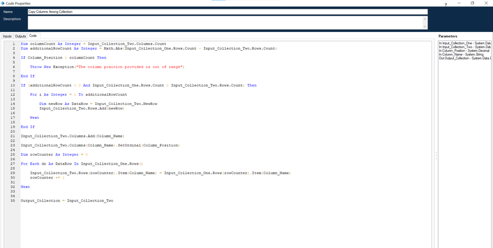

I am posting the solution for use case one in this post and the use case two has been posted in a separate thread message due to character limitations.

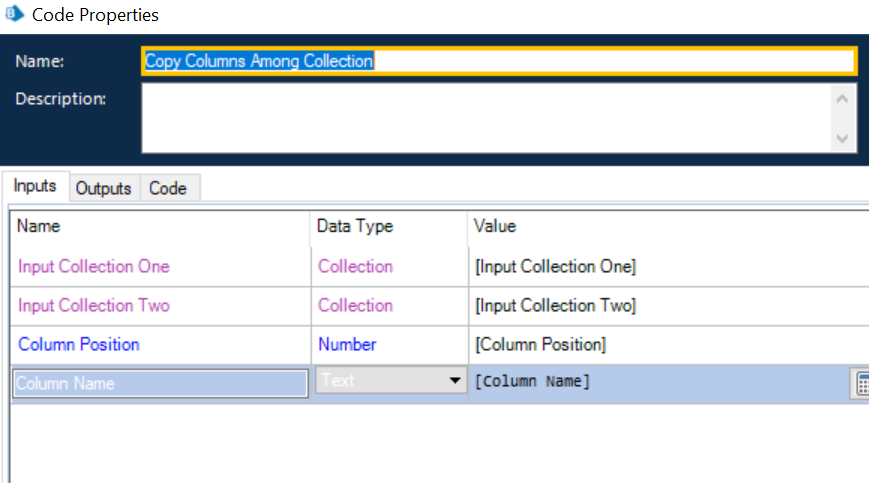

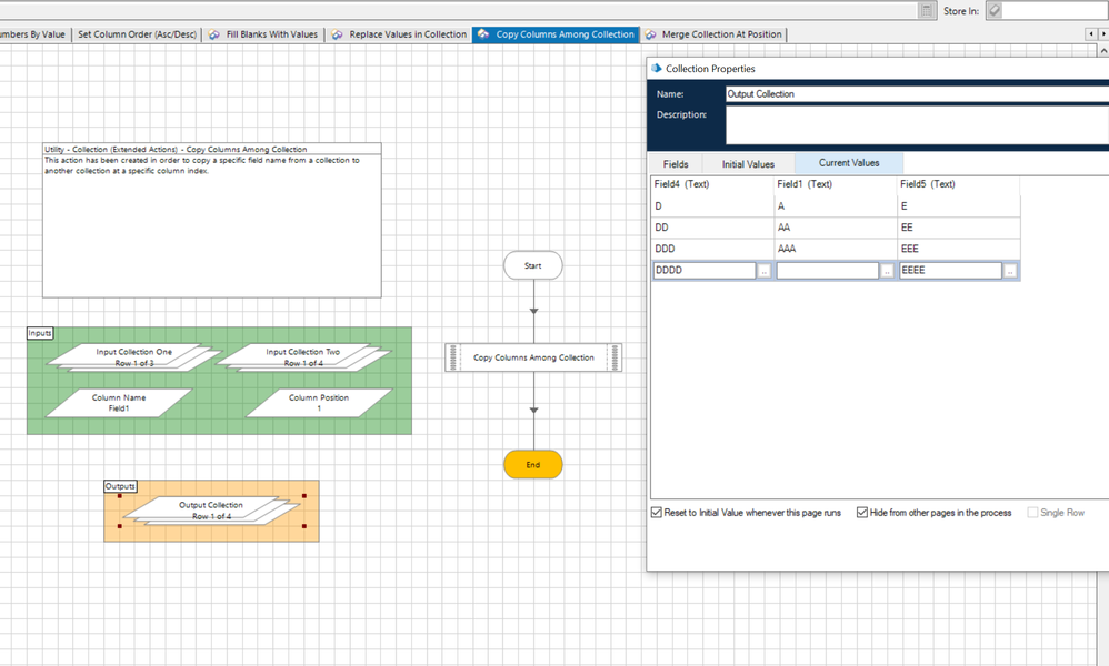

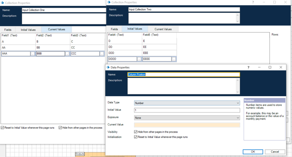

Use Case - I :
Create a new action called 'Copy Columns Among Collection' by extending the 'Utility - Collection Manipulation' VBO. Add the following input parameters to this action:
- Input Collection One (Collection) : The input collection from where the column data needs to be copied.
- Input Collection Two (Collection) : The input collection where the column data needs to be added.
- Column Name (Text) : The name of the column in the first input collection from where the column needs to be copied.
- Column Position (Number) : The position index of the column in the second input collection were the column data needs to be added. The index must start from 0 till N-1, provided that N is the total number of columns.

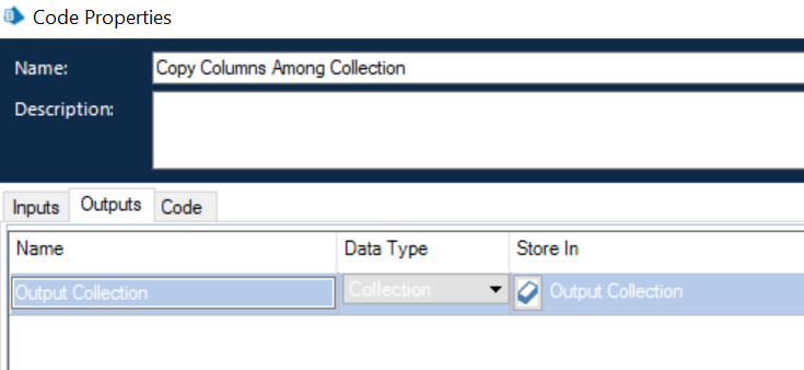

Solution Workflow:
Code:
End If
    Next
End If
Input_Collection_Two.Columns.Add(Column_Name)
Input_Collection_Two.Columns(Column_Name).SetOrdinal(Column_Position)
    Input_Collection_Two.Rows(rowCounter).Item(Column_Name) = Input_Collection_One.Rows(rowCounter).Item(Column_Name)
    rowCounter += 1
Next

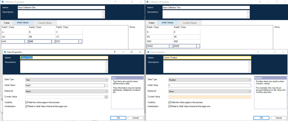

Test Scenario:

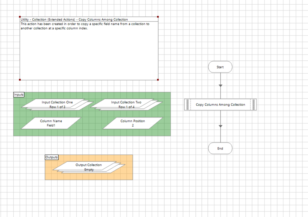

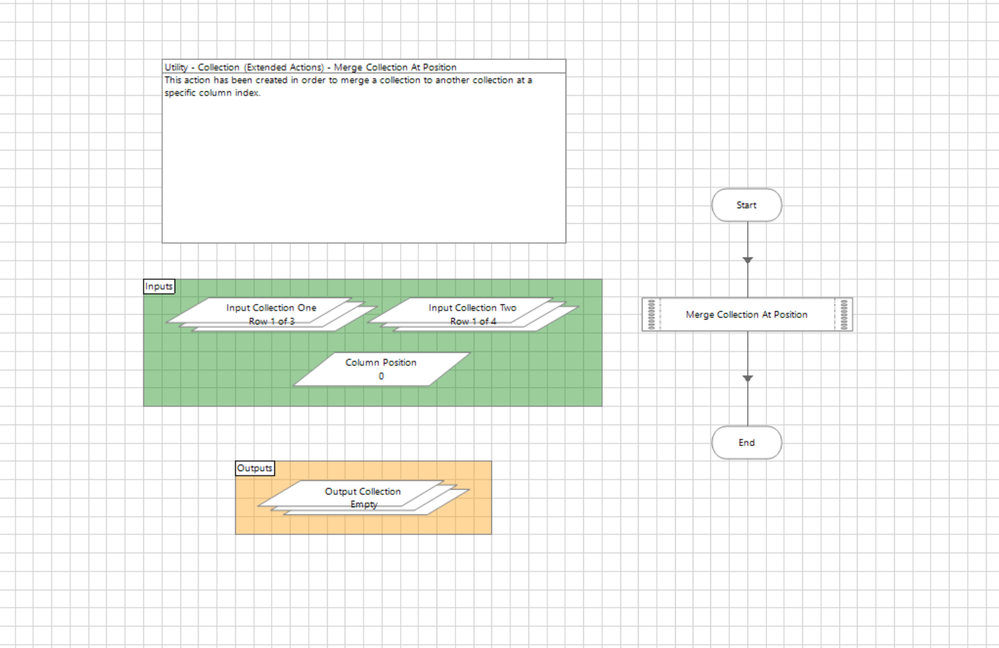

Hi Devneet ,
I tried this code and the problem is in the output .
The flag is shown true but the output collection is empty.
Where can be the problem ?
Thank ,
Erjola
Erjola Mema
