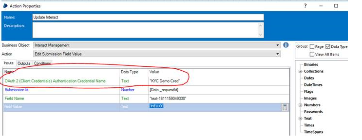

We're working on Interact Forms in a BPC sandbox setup, and so we have the use submit data for fields A, B, & C. The BP process will calculate/obtain data for fields D & E.
We would like to get that data back to Interact so the user can see it on their Interact Dashboard (My Requests).
The Interact Management VBO requires a credential setup for most parameters. However we don't seem to have the correct config for this credential.
When attempting to use these actions to send back info to Interact, we get Internal errors saying the server could not be found, etc etc.

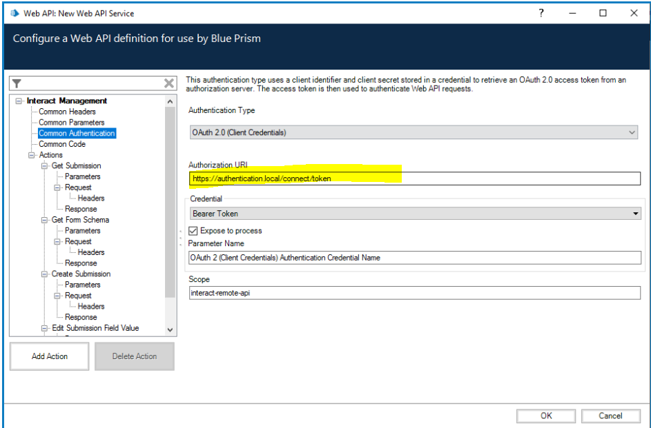

It can be a little bit confusing 'cause actually there are two objects related to Interact; one is the Web API which makes all the calls back to Interact and the second is the VBO which calls the Web API. The VBO is the one that you want to be using in your process design.
The image on the left is the Web API (Interact Management) and you need to pass in the OAuth2 credentials. The image on the right is the VBO (Utility - Interact API) which handles OAuth2 and other stuff under the covers.

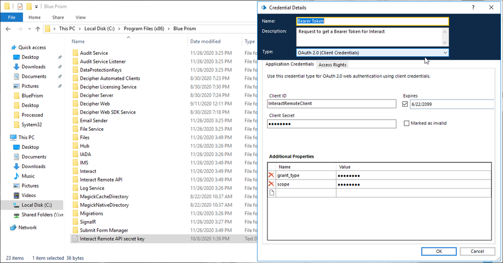

You also need to make sure that the Bearer Token credential is setup with your unique API key. The key is written to a file in the install directory.

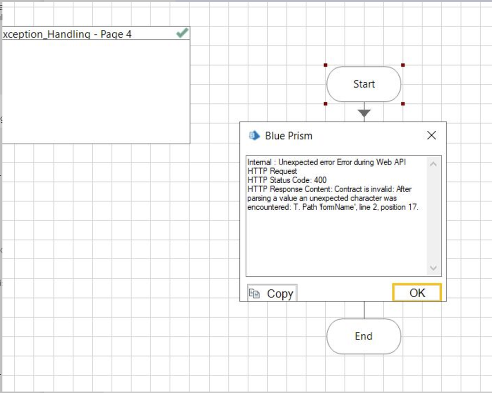

I am facing the same issue Anton facing,
getting 400 error when i tried to connect interact from BP through web API using the following URLS
https://interactremoteapi.local
https://authentication.local/connect/token
While getting
and i have configured the credentials manager  as following
Please suggest what action i should take to get the form details from Interact to Blue prism .

You have to update authentication server url in Interact Webservices.
