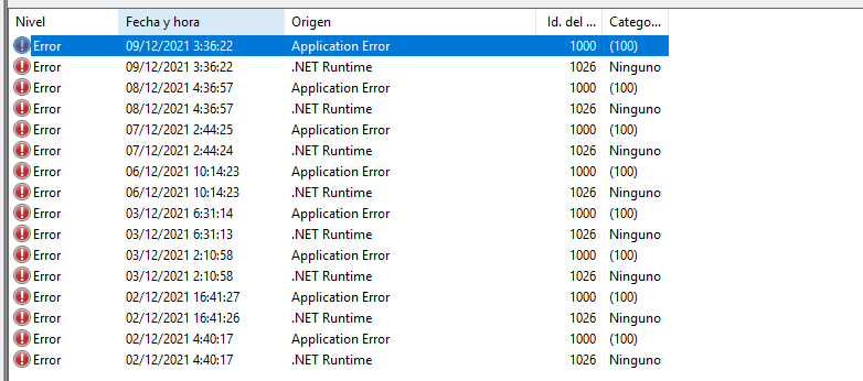

- These are the errors we have observed from Windows Events in the Interactive Client:
The actions we have taken to try to solve the error have been to reinstall the .NET framework and implement the GC.Collect() function after processing each item in the queue of processes. This has not had a favourable result.
