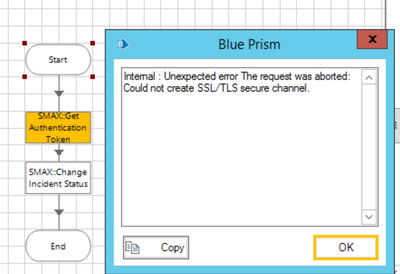

I'm trying to automate an application for one of my clients. The requirement is to raise a ticket in SMAX internally. We are trying to use Web API for raising the request. When I run the Get Authentication Token Action facing an issue like "The request was aborted: Could not create SSL/TLS secure channel."

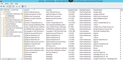

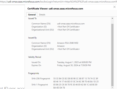

I have attached the screenshots for Certificate root on my machine and also the certificate details of my SMAX URL. How can I find that the certificate listed in my computers trusted CA list
07-05-24 02:18 PM
I don't see Amazon listed in your Trusted Root CA list. If you download the certificate you should be able to right-click on it, I believe, and import it into that store.

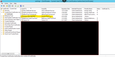

08-05-24 10:43 AM

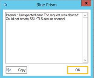

I have downloaded the certificate and import to the Trusted Root Path. Then I try to rerun the process still facing the same issue.
Please find the attached screenshot below:
