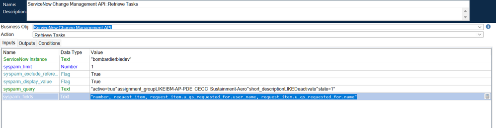

above is in format of python but same is given in BP as well as you can see in below screenshot -
now if you notice I have setup
sysparm_limit as 1 and
sysparm_fields for some specific fields which includes variable fields as well.
in another words it is returning response with all the fields and not only those given in the payload. another issue is it is not returning the variable fields for example "variables.src_comments_details"
please let me know if anyone can resolve this?
Thank you!
Mritunjay Tiwari

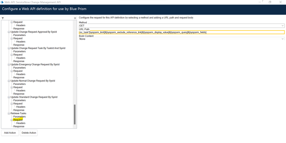

The BP WebAPI configuration has HTTP GET request with URL parameters but from your python code it looks like you are performing a HTTP POST request as there is a payload.
Is this a custom action that you have added because I could not find it on the WebAPI available on DX? If you are looking to make a HTTP POST request you will have to modify the WebAPI configuration accordingly.
One other thing I noticed in the BP URL configuration is that the query parameter name is missing.
Generally it is of the format ?paramname1=paramvalue1¶mname2=paramvalue2...etc.

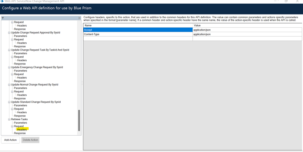

08-11-22 05:50 AM
@MritunjayTiwar1
If you can also provide a screenshot of your WebAPI configuration in BP that will be helpful to find out what's the difference between the two.

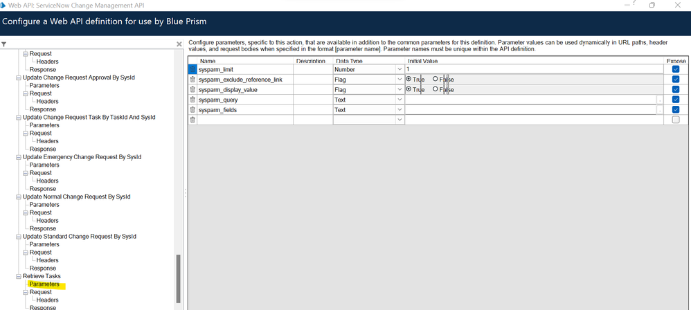

Hi Shashank, update as per your request.
Mritunjay Tiwari
Mritunjay Tiwari

08-11-22 12:59 PM
Thank Shashank for bringing my notice to the url parameters - paramname1=paramvalue1¶mname2=paramvalue2...etc.
this has resolved my issue.
Thank you once again.
