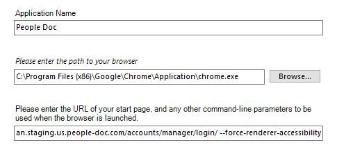

07-08-20 06:57 PM
Our issue has been resolved.
Barry Bell
RPA Manager
DHGLLP
America/New_York
The fix for it was in the app modeler set up to use this in the url spot
oururl --force-renderer-accessibility Now when Blue Prism launches it, it uses the --force-renderer-accessibility
