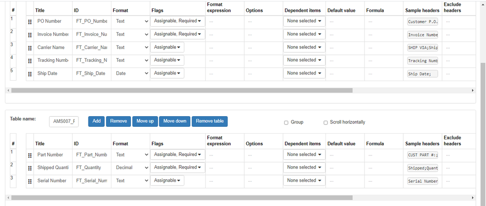

I am training Decipher on different types of invoices. Usually one of the fields I am looking for: Part Number is supposed to be under the Item Number column in the below image.  And it works fine if the Part Number is to be taken from Item Number column.
For this particular type of invoice,  the part number is the one beside CUST PART header and Quantity is the one below Shipped Column.
I have trained Decipher multiple times to identify the CUST PART # field but it is returning an empty value in the Part Number & also in the Quantity field.  I have already added sample headers to the DFD.
Please let me know if there's any other way I can help Decipher identify the same.

3. Please can you add a screen shot of the DFD?
A: Yes, it is attached.

1. I can see you have put the header "CUST PART #" in your heading for Part Number, is this the only heading in there? Good if so, otherwise you may have some difficulties, but we can come to that if needed.
2. All good answers, so we will have to get a little more into the detail. Each document going into decipher will be used to update the training data, but this will only impact similar looking documents, not all documents for that DFD.
This training is based on matching documents with previous examples (from different suppliers) and it may be that there are some quite similar that are affecting each other. You can set the match percentage in the miscellaneous parameters by using "TemplateMinMatchPercent=", the default is 60, so try a higher number like "TemplateMinMatchPercent=70". This can go in any field of the main document.
As you have done lots of training already, this may take a little longer to correct the training data.
3. Please ensure the ML model is switched off during this phase of training.
A: Since we have about 100 different formats, we do not have 1 constant header. I have added about 4-5 common headers. Is this an issue?
I will try updating the match percentage as 70% and see if that helps.
Any estimate on how long it can take to correct the training data and will this effect previously trained invoices?
Also, the ML model is turned off in the Document type.

Decipher is able to read fields from the first table of DFD like PO Number, Invoice Number easily when the part number is in the shipped column. But it doesnt read any data within the second table like Part number, Quantity, Serial number.

When you say first table, am I correct to assume you mean the top section of the invoice and that you haven't set it up in the DFD as a table?
This is important as Decipher does not support more than 1 table in the DFD.

Yes I meant the top section of the invoice. The second section with Part Number, Shipped Quantity, Serial Number is the only table in the DFD.
