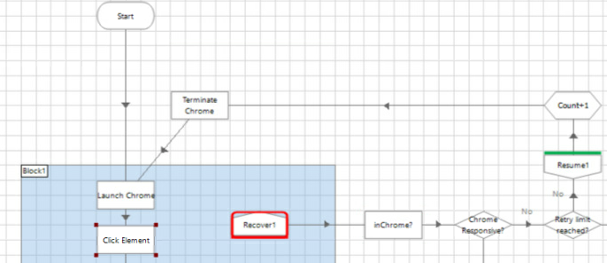

I am pretty certain it has to do with the way Blue Prism attaches to chrome pre 6.10 (port issue) rather than the element attributes being dynamic or wrongly spied. She is saying that this worked before in IE, and since the migration to Chrome, it stopped working.
Tracy, the only workaround I have found so far (which is not 100% reliable but, in our case, does the trick), is to include recovery logic to shut down/kill chrome in case of the element not being found > try launching chrome again and see if the element is found,
Something like this:
If this still fails, the only solution is to reboot the Resource.
Good luck!

TracyGreen
Thank you for all the responses.  We found something that seems to resolve  95% of cases.  We are now spying the window in win32 mode.  When we encounter the problem, we're doing something similar to what Ramon is suggesting, but we are calling a close on the element rather than a terminate for the root Chrome.  We put this in late yesterday and our numbers this morning were much better.
