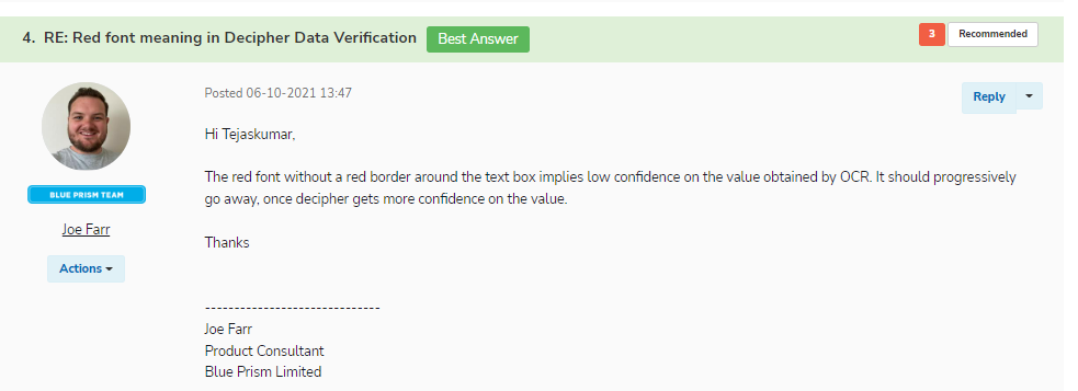

Is this is the thing you guys are discussing about?
Hi, Neeraj,
nope, we discussed the red border not the red font. I saw that thread and read it through but I could not find the explanation about red border.
