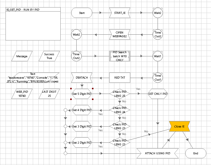

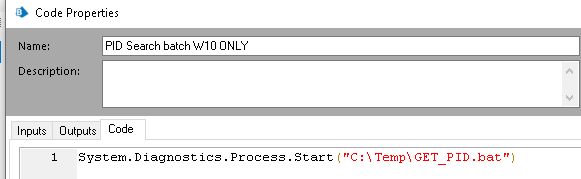

Sorry for the delay, for that, I create a batch file, that looks for the PID base in the Window title.
EXAMPLE: I have IE open with two taps, one is in Amazon the other tab for NBC.
Create this batch file and run by BP using a code stage.

This creates a file like this:
"iexplore.exe","18740","Console","1","56,372 K","Running","BPUS0350\Luis Lopez Castro","0:00:02","Amazon.com: Online Shopping for Electronics, Apparel, Computers, Books, DVDs & more - Internet Explorer"
Then in BP read the TXT file to a data-item, later use a few calculation stages to see the length of the file, and look for the PID.
I hope this work for you.

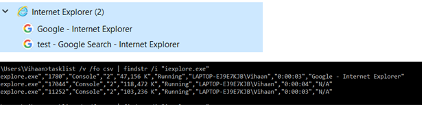

@Luis Lopez ​- Thanks a lot for your response. I tried multiple things based on above discussion and have some observations -
  • Command tasklist
This command has same issue which I mentioned above as well, i.e. it returns window title of only active window. I have 2 IE open in first I have searched 'Test' in search box and navigated to search page. The title for it is – 'test - Google Search - Internet Explorer'
2nd browser I have just launched google.com, the title for this is – 'Google - Internet Explorer'
When I check my task manager I am able to see both title clearly as in screenshot –
However when I check on cmd with command - tasklist /v /fo csv | findstr /i "iexplore.exe" I am able to see only 1 window title, rest shows NA.
Please suggest a way so that I can get all window titles for a process (like iexplore.exe) so that we can match title exactly and then pick up PID and use it to attach. PID is probably a good way of attaching as it will be unique but to get PID is a challenge here. Also any provision on BP to capture PID at time of launching application might help?
