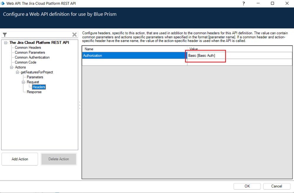

I recently started setting up the JIRA API skill, and have followed the User Guide that comes with it and gone through each step. I have set up the API in the 'Web API Services' section of the BP system settings. I have set up a credential and obtained an API Key from Atlassian. However whenever I try to run it in a process, I keep receiving an error message, "HTTP Status Code:401; Basic authentication with passwords is deprecated".
I have looked in the BP communities, and read through the Atlassian documentation, although I can't seem to find any information on where I am going wrong. Any help on resolving this would be greatly appreciated. The credentials I have work fine when logging in manually.
Please see below for some screenshots of the error message, and API configuration.

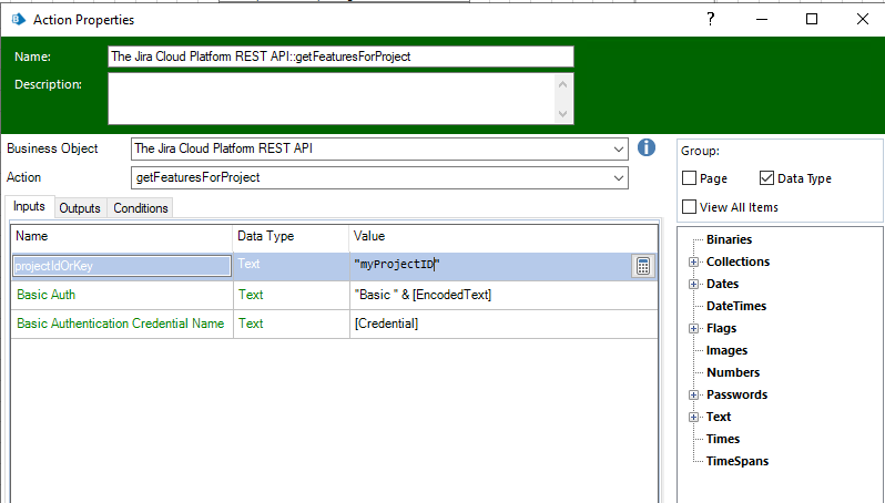

Hi @Manish Kumar,
Many thanks for the reply.
Yeah, I use the Base64 to encode the key as "myemail:apiKey".
I then passed this encoded text into the "Basic Auth" input as: "Basic " & [EncodedText]
Please see below:

@Benjamin Anderson,
So you're passing "Basic " & [EncodedText] into the WebAPI for the Basic Auth input parameter. All you should be passing in is [EncodedText]. The WebAPI definition already accounts for the "Basic " portion of the header value.
Thanks @ewilson,
I made the change you suggested but unfortunately, I'm getting a status code of 401 now. "HTTP Response Content: Basic authentication with passwords is deprecated". (Which is odd as I'm not using a password - just the API key).

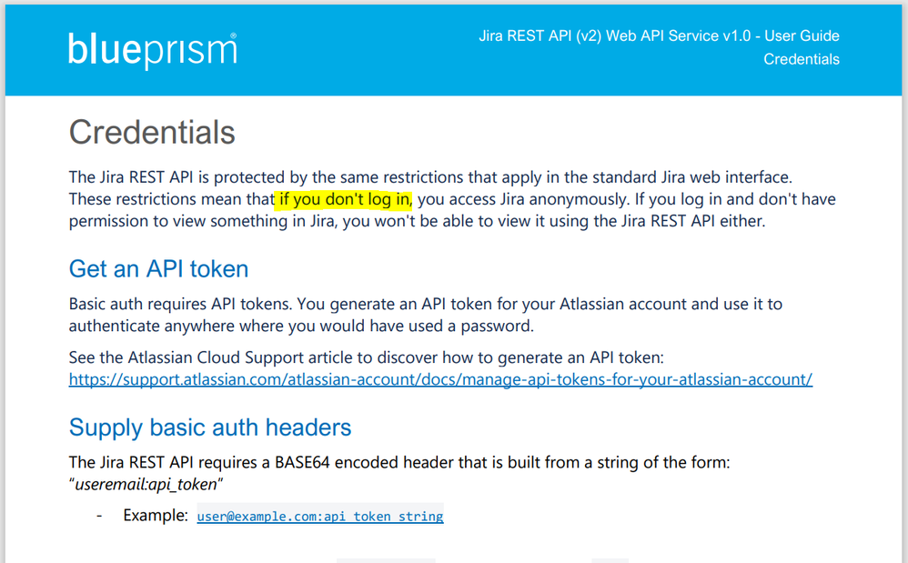

Hi @ewilson,
I was reading through the user guide again for the JIRA api, and noticed the below comment.
Does this then mean that I have to manually log in to JIRA through the browser in order to use the API?

Hello @Benjamin Anderson,
No, I don't think that's the case. It would defeat the purpose of having an API. I'm checking with the developer of the connector to get their input though.
