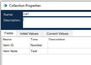

Is there a way to identify in a Collection object which field is the Key Item to enter into a Queue?

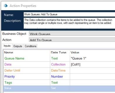

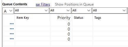

In Section 9 of the Foundation Training, the first activity is to process data that is in a Queue.  The first problem is that there is no data available in the queue.  So going back through the videos I found where it was demonstrated how to Generate the Queue records.  My problem is when I run the procedure, the records load but there is no Key Item identified.  Where in the Collection Object do I define the Key Item?

Hi Gene and welcome. You specify the key field name when you create the queue. Then whenever you add items to that queue, you need to make sure the collection input contains a field with that name. If you don't the queue items will still be created, and will still be accessible from a process, but in control room the Item Key column will be blank.

And item key has nothing to do with 'primary key' in a database table, it does not need to be a unique value. If you want to be sure it is unique then prior to adding you need to check if the key value already exists in the queue (by using Is Item in Queue)
