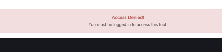

Hi Akhil,
I am trying to open the above link but I'm unable to open that. I did login logout multiple times. Please suggest me.
Sahil Chankotra
