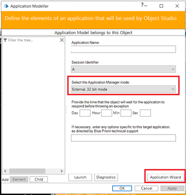

Sviatoslav93
I have also spent a lot of time on this issue and read gigabytes of information.
The solution was in the Application Modeller settings. Try using a different application Manager Mode - for my BluePrism 7.2.1 64 bit case, the ‘External, 32bit mode’ mod was suitable.
