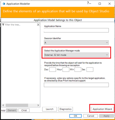

Trying to launch the mainframe application IBM iAccess Client Solutions using the IBM iAccess (EHLLAPI) connector of Blue Prism.
The error received during launch of the application is as follows:
"Error - Failed to launch application - Could not load dll - PCSHLL32.dll " .
  • Also, while attaching to a running instance, the error received is as follows: "Internal : Failed to perform Step 1 in Navigate Stage 'Attach' on page 'Action 1' - Terminal Emulation - Could not load the dll - PCSHLL32.dll"
