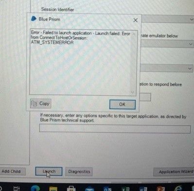

Hi, did you get a solution for the above issue. We are also facing a similar issue and below is the error
Hi all, Need help
we are getting the attached error "Error - Failed to launch application - Launch failed: Error from ConnectToHostOrSession: ATM_SYSTEMERROR" when we are trying to Launch Attachmate Extreme session using Mainframes.
We are providing application type as "Micro Focus Attachmate Extra !X-treme9.3(ATMAPI32)
Session identifier as "A"
and variant as "Extra!"
and Application manager mode as "Embedded"
but still we are receiving the "Error - Failed to launch application - Launch failed: Error from ConnectToHostOrSession: ATM_SYSTEMERROR"

Few things you can check here :
1- Try launching the application with elevated\admin rights.
2- Check on other user machines if the option is enabled for them (Can be a chance its your access level causing this).
3- Pointing to the exact .ws file and path .
Vipul Tiwari

06-11-21 08:19 AM
Thanks for the reply Vipul. Let me try launching Blue Prism using elevated rights
