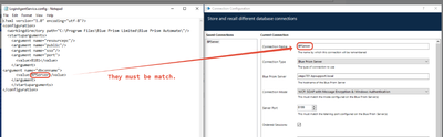

One of the possible causes is the Connection Name is not configured correctly in the Login Agent Configuration file:
Confirm the connection name configured in the Login Agent configuration file matches the one in the Interactive Client - Configure Connection screen.
If you use the /sso switch to communicate with the runtime, you may also need the /sso switch in the Login Agent configuration file
