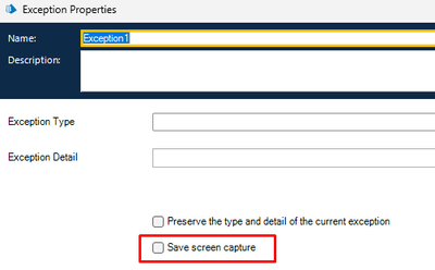

13-08-24 11:29 AM
Maybe try to screenshot the failing RR to see if that yields any clues?
13-08-24 11:33 AM - edited 13-08-24 11:34 AM
