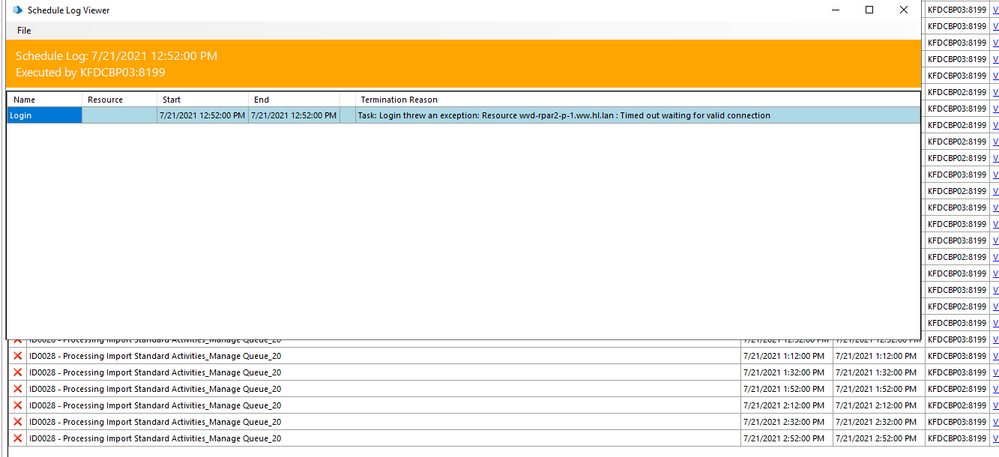

Dear Community,
We were facing the issue for Scheduler and wanted to know how to avoid it:
  • Timed out waiting for valid connection
  • Blue Prism Version: 6.10
  • Exception was for a daily used machines (so not for a new ones)
  • Processes worked when you dragged them into machine manually
  • To fix it: Restarting Application Server was performed
Could you please diagnose what caused that error and how to avoid it?
