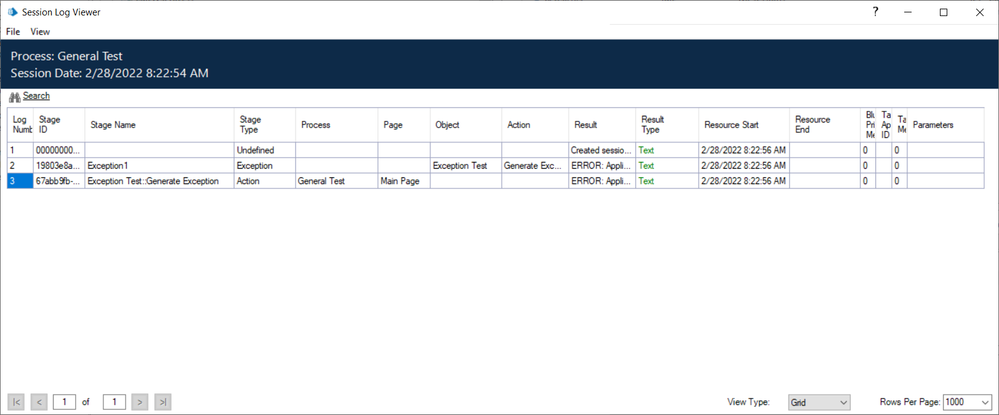

ewilson
@Tejaskumar_Darji,
I ran a few tests and here's what I found. With Session logging set to Errors Only there​ are entries in the session log for:
  • Creation of the session log. Even if you don't encounter any errors in the process there will still be a single entry for the creation of the session log.
  • An entry for the exception that was raised
  • An entry for the Action stage that caused the exception.
None of the following stages were logged as long as they didn't encounter any errors.
Hope this helps.
