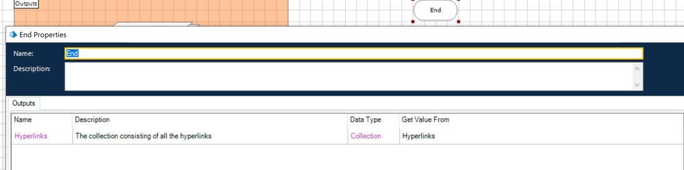

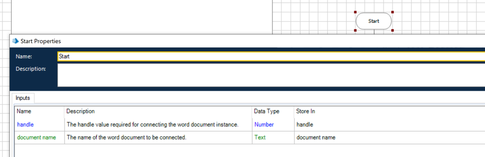

In order to achieve this, we can extend the "MS Word VBO" by creating a separate action within it and you can call it as "Get Hyperlinks". This action will be having the following input parameters:
This action will also have an output parameter called 'Hyperlinks' which is of Collection type which will consist of all the extracted hyperlinks from the supplied word document.
Refer to the below workflow for more information:
Input Parameters:
Output Parameters:

For your given use case, you can extend the MS Word VBO by creating your own custom action as shown in the solution below:
Solution Walkthrough:
- handle (Number) : The data item having the handle value in the instance dictionary that needs to be queried. (This you can get from Create Instance action)
- document Name (Text) : The document name of the current workbook which the Blur Prism bot is operating on. (This you can get from Open Workbook action)
Input Parameters:
Output Parameters:
