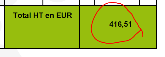

Hi
I am trying to read the value which has color background , Decipher is not able to map the value in the given text box. but when i keep cursor in the text box it is highlighting any technique please .
attached the imaged.

I don't know much about Decipher so I don't know if I can help you, but have you tried reading it in grayscale?

I didn't see this grayscale option, can you suggest where it is , it is not in flag /Mis parameters

Hi Krishna,
There's not currently a facility within Decipher to convert images to greyscale, you will need to look into 3rd party options at this time. To test you could use your usual image editing tool to convert it manually.
This is a challenge from the Tesseract OCR engine not being as consistent with text on coloured backgrounds. We are working on a remedy for future versions.

Thanks Ben for information,
what I have noticed is ,
if I resize the OCR region the value is not getting mapped to respective field . I have restarted the all decipher services
any suggestion

Hi Krishna,
As mentioned, the Tesseract OCR engine will have difficulty with coloured regions. As per Mitsuko's suggestion, I would recommend trying to convert the image to greyscale and trying again.
The OCR engine used during data verification is different to the one used during the original OCR stage, so you may get different results.
