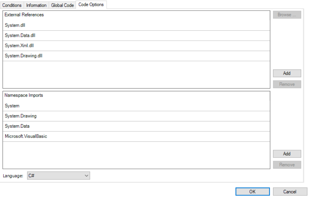

Hi guys,
Have added Microsot.Visualbasic.dll at External Reference into the Code Options tab and Microsot.VisualBasic.Strings at Namespace Imports and i get this error ==> "Microsot.VisualBasic.Strings is a type not namespace".
If i remove the Strings from the namespace and leave only Microsoft.VisualBasic then i got 200 errors.
What should I do to bypass this issue.
Into the Global Code I have a lot of C# code.
thank you for your answer!

Hi Cohen,
It looks like you have spelling error in namespace, but maybe its only in this post, pls double check that: is Microsot.VisualBasic or Microsoft.VisualBasic
Maybe this is the reason.
But probably, you need to write in the namespace only Microsoft.VisualBasic without Strings. As Strings is a class name, not a namespace.

Spasibo balshoie Dmitry! It did the trick! had a typo out there!

Try without referencing the dll. Just use the namespace import you have for 'Microsoft.VisualBasic', and see if that works.

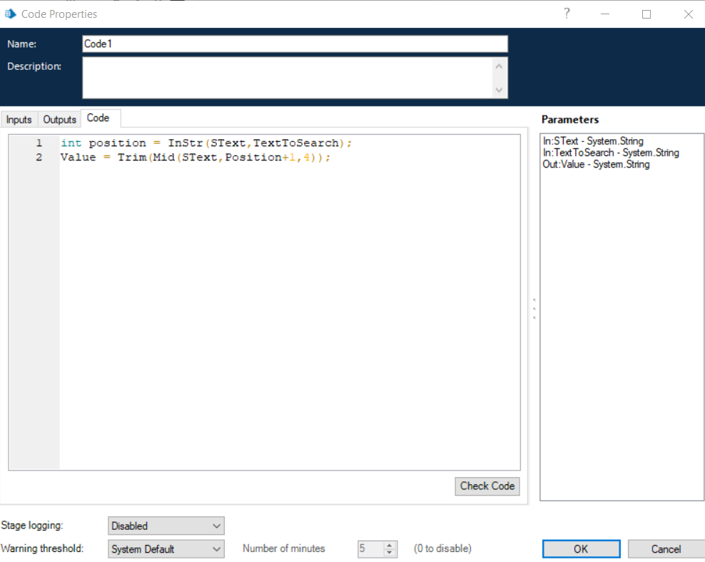

Hi Davis, Tried your way.
But now I am getting new error that is saying "Page: Action 1
Stage: Code1
Type: Error
Action: Validate
Description: Compiler error at line 2: The name 'Mid' does not exist in the current context
Repairable: No"
If do not mind can you please tell me how I can get Microsoft.VisualBasic.Core.dll so that I can put it in my "Blue Prism Automate" folder.
and do you know the Difference between "Microsoft.VisualBasic.Core.dll" &  "Microsoft.VisualBasic.dll". Because I have also tried using the second DLL file but still getting the same error.

Hi Davis, I was trying to do use some prebuilt visual basic funtionsin code stage like MID(), Trim(), etc.
Soumya Behera
Why do you even need VB methods in C# code?
Left/Right/Mid => Substring, Instr => IndexOf, Trim is same.
C#: value = SText.Substring(SText.IndexOf(TextToSearch),4).Trim();
