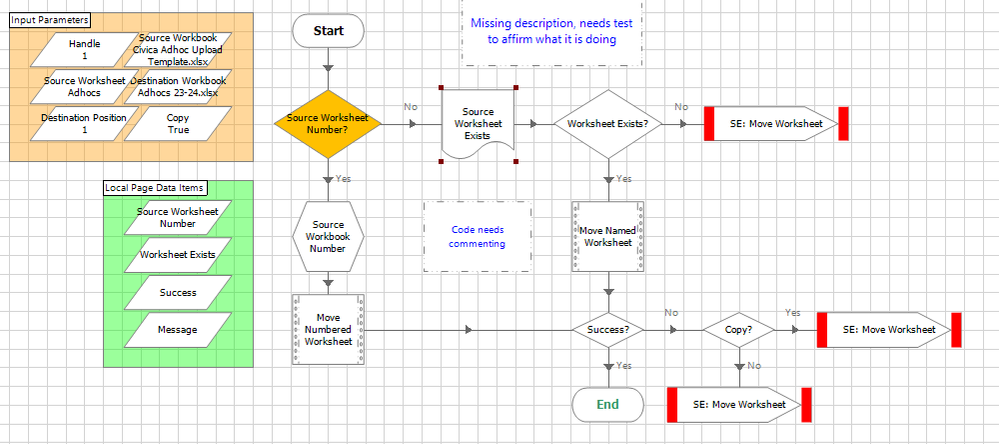

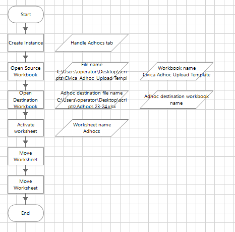

I am trying to move a worksheet from one Excel document to another and save. Originally I had issues with the save action in that when I reached this point, Excel would always enter into a 'Not Responding' state. This happened when I tried to perform the process manually and as an automation.

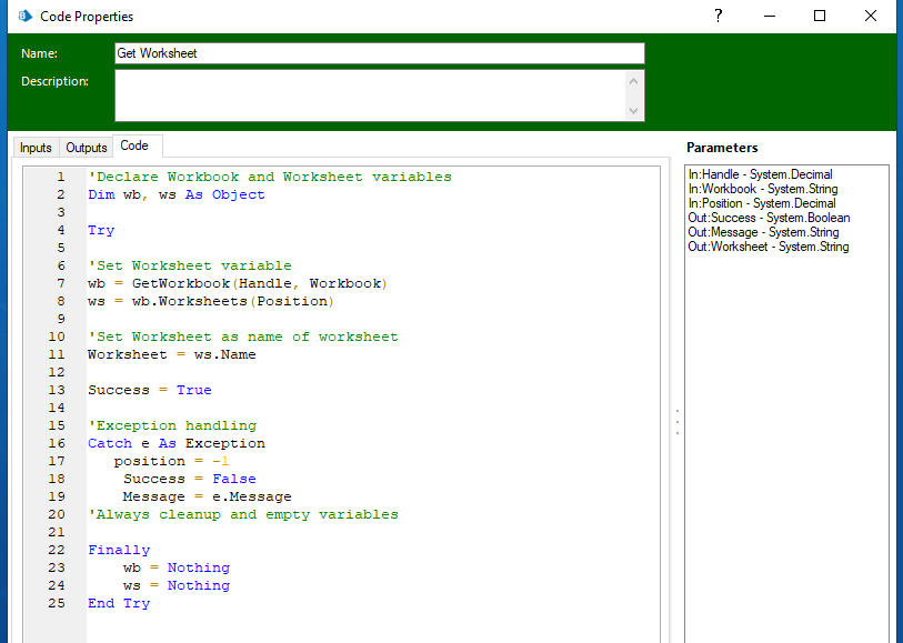

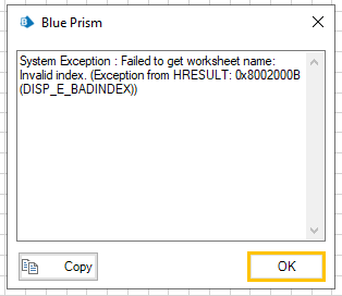

However today, I am getting an error before the save point is even reached and I can't even copy the worksheet because of being unable to get the worksheet name.
I don't know why I am getting this error when I've got the worksheet name as a data item.
I've stepped through the stages and noted a breakpoint was set here at the 'Source Worksheet Exists' page. I removed it so the process could continue, but it didn't resolve the problem.
This is the point where I encounter the error, but I don't know enough about this build or the code to work out if there's an issue with that or if it's how I'm building my process...

Second question: You noted that you are now encountering another error before the saving step. In the logs of the MS Excel VBO object, is there any history of changes? Someone may have altered something in the code. It would be helpful to download a new updated utility and overwrite what you are using.
How is the naming of the worksheet? How many sheets are there? You could try obtaining the name by position and inputting it as a parameter in the Get Worksheet command.

05-02-24 01:45 PM
If there's no position, and there's no default position of 1 being fed in, then it will fail.
Position needs to be given an input number (>=1)
