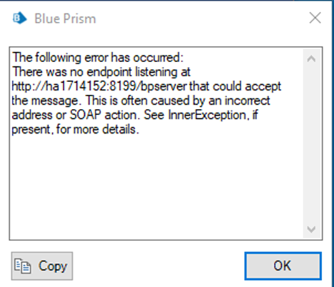

My Blue Prism server was working fine and then I fiddled with something but cant recall what and now I have a 'BPServer.exe. results in error when trying to start the server service.

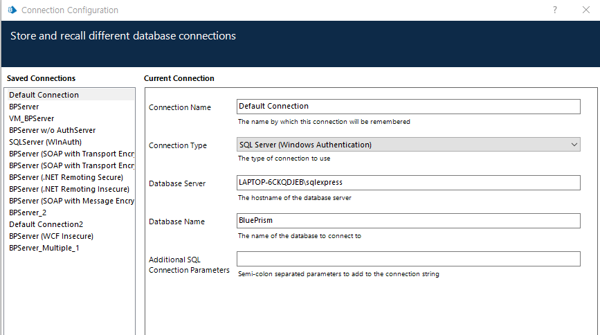

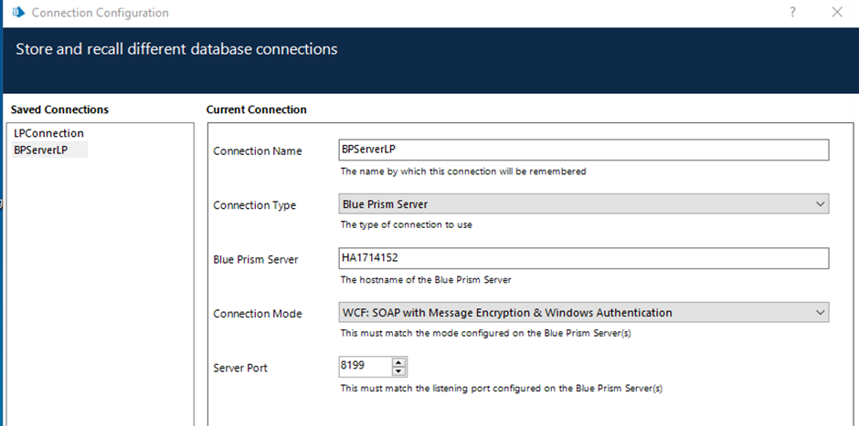

My BPServer connection matches whats in the server configuration i.e.

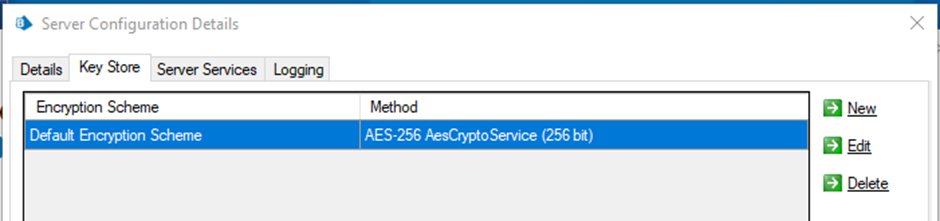

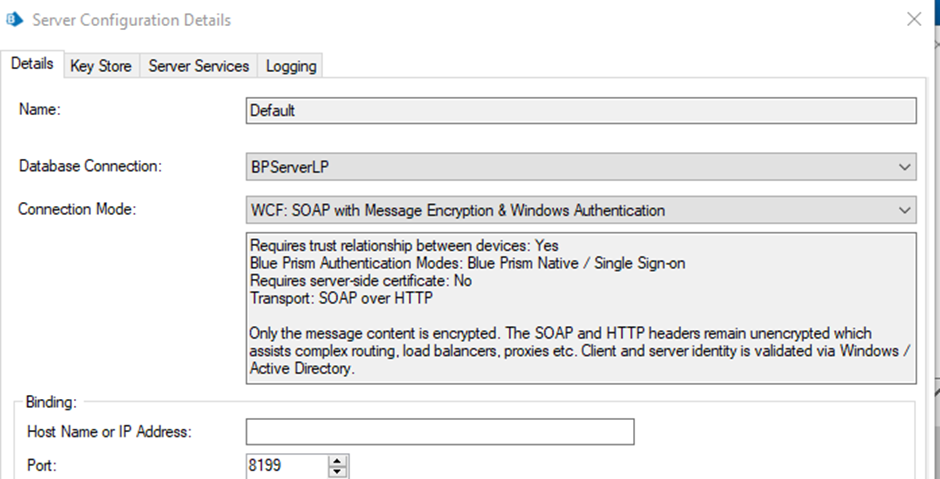

And in the server configuration

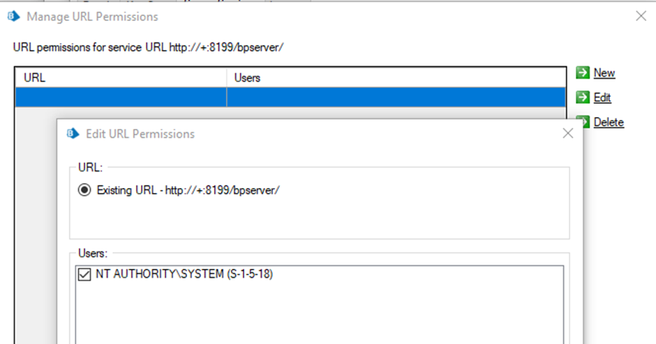

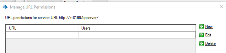

If I click on manage permissions
If I click on 'Edit'
Nothing looks anything different to how it was. I usually start the server by command line

and again thats always worked in the past. I've had a look in the event viewer but cant say it was very helpful
BPServer.ServerService
An error occurred while trying to start the server
System.ServiceModel.EndpointNotFoundException: There was no endpoint listening at http://ha1714152:8199/bpserver that could accept the message. This is often caused by an incorrect address or SOAP action. See InnerException, if present, for more details. ---> System.Net.WebException: Unable to connect to the remote server ---> System.Net.Sockets.SocketException: No connection could be made because the target machine actively refused it [::1]:8199

As far as I can see SOAP and address all match so stumped as to where the issue lies. Any guidance would be appreciated

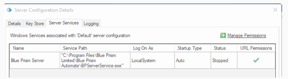

09-08-22 07:28 AM

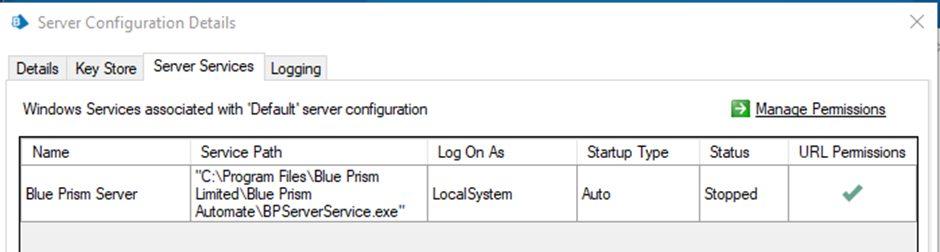

It seems the BP Service is not running and for this reason the log indicates that there isn´t endpoint listening. In the 5th image you linked you can see that the status is "stopped":
The command line that you indicated is to start de RPC no the server. Just try to access to the server and start de Blue Prism Service.

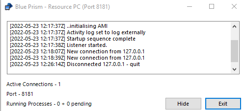

The command line always worked before and this was setup by a Blue Prism Support Tech who remoted into my PC and set it up this way. My understanding is the 'Server' is on the local (Resource) PC and not a networked server. It has only just stopped working and I think it was after I was playing with the 'Manage Permissions' in the screenshot above but as far as I can tell I have put it back to how it was and then it stopped working.
Running the command line usually displays this
But now I get the error instead

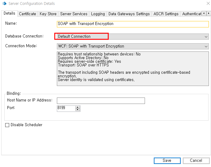

10-08-22 01:26 AM
I see in your BP Server configuration that "Database Connection" is set to "BPServerLP".
And the "BPServerLP" is defined as a connection profile to connect to the BPServer (not Database).
Considering the Blue Prism architecture, RR<->BPServer<->Database,
It would be worth to try changing the Database Connection setting of the BP Server to direclty connet to the Database.
