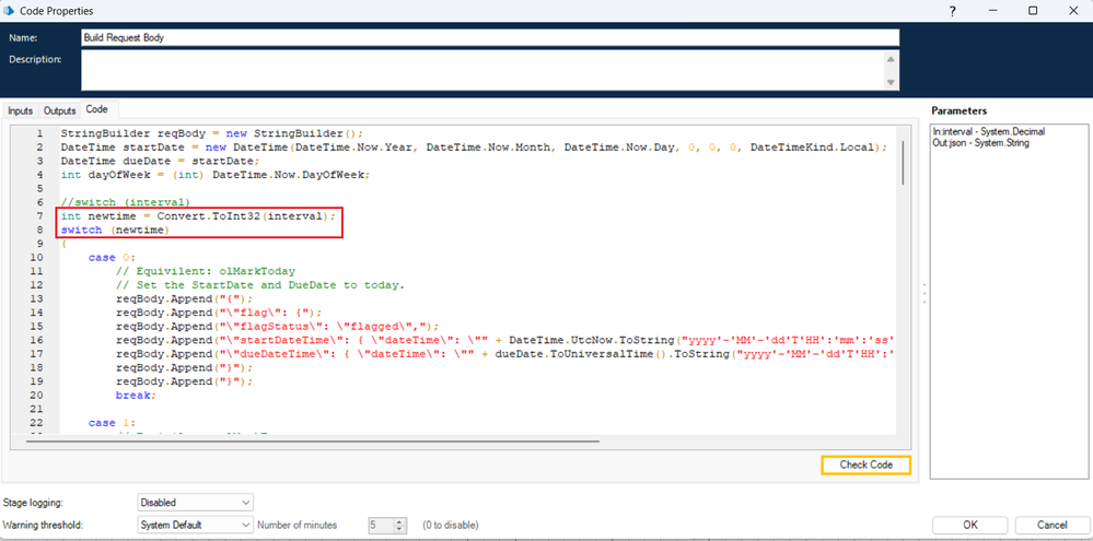

I have imported the object in both V6.4 and V7.1.2 along with all dependent objects.
I can see 2 compiler error in V6.4 and not in V7.1. Could you please help on the same?
Attached screenshot for your reference.
Sumit Kewalramani Software Engineer
@SumitKewalraman,
Both of those compiler errors are basically red herrings. You can address the first one by chaning the code of the Code stage slightly. Open the Code stage in that action and replace the existing switch (interval) statement on line 6 with this:
The input parameter interval is a Decimal value which shouldn't be a problem for the switch statement, so I imagine it's an issue with the .NET Framework version being used under BP v6.4. The above change will simply convert the Decimal value of interval to an integer and use it in the switch statement.

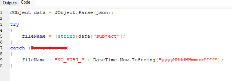

As for the second exception, again it shouldn't matter and should not stop you from being able to run the action on the VBO. If it does, simply open that Code stage and remove the Exception ex definition:
