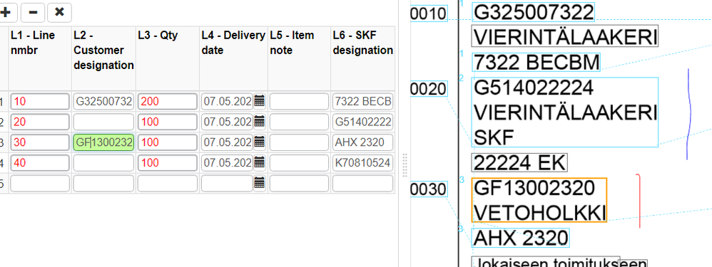

When I am training a document in Decipher, I noticed a strange behavior against the regions marked by Decipher.
Can see the same in the attached screen with red and blue color lines. is there any additional settings needs to be done ?
I am doing simple rule based training ( not ML). Here expected one is as first line after the number " 0010/0020"
If you observe 1st line read properly
2nd line not read as it marked region for 3 lines in pdf
3rd line it mapped the value but wrongly and region marked  for 2 lines
Any idea from any one ?

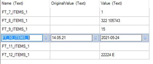

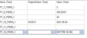

9845.pngIf you observe the above image it find all values correctly but when I read the values i from BP Q for further process Date converted wrongly as below
Date-1   ---- Wrongly  return different date got printed  ( 24 printed instead of 14)
Date-2  -- Correctly return the value

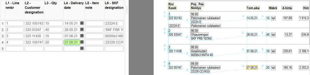

9847.pngThis pattern like 1 and  3 lines came wrongly and 2nad 4 converted  wrongly
I have set the column as Date and i will get different  format for the same DFD.

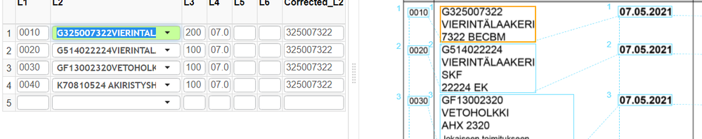

  • I have created an extra column ( corrected_L2 Autocalcualte) and applied formula as SUBSTR(FT_2_ITEMS_0,1,10) for testing
  • I have created L2 as assignable and multiline  then i got  value in new column as shown below
  • the value in L2 came as  "G325007322VIERINTALAAKERI7322 BECBM"
  • Then I added a flag for new column as  "Dynamic list " but still i am getting  al 3 lines as one string
  • and if observe corrected column it is not calculated values as per L2 it printed first line value for all lines.

I'm not sure why you've added the Dynamic List flag, this corresponds to a SQL database lookup function (you can get a value/list from a database based on a value read from the document, dynamically).
If you have the multi-line flag set, this should output the read field as it's written. I'm not aware of a formula in Decipher that can then split this by line break, but I'll check with the development team and come back to you.
