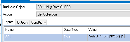

I am facing an issue. I would like to get data from excel sheet, but this sheet has a space in the name.
Already tried
Have any of you had the same problem, or you know how to solve it?
Query from the picture:
Already tried
['POD $']
,[POD $]
and [""POD $""]
.Have any of you had the same problem, or you know how to solve it?
"select * from ['POD $']"

@DamianDabrowski,
Are you trying to use the brackets as a BP data item replacement? Is the name of the sheet just "POS $"? If so, have you tried "select * from 'POD $'"?

26-09-21 01:33 PM
If the file name is POD $ this will work --> "select * from 'POD $'"
If its a data item which you are passing --> "select * from '" &[POD $]&"'"
