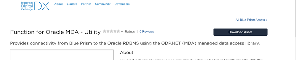

There's a lot of "Oracle" out there. Are you referring to Oracle RDBMS or any of the many Oracle products/platforms out there? If you are referring to Oracle RDBMS then there is an Oracle RDBMS VBO on the Digital Exchange that makes use of the Oracle ODP.NET library. You can find it here.

Hi Ankit,
I was able to connect to to ORracle 11g databse and perform the operations there. So essentially, the requirement was to execute custom stored procedures in Oracle database and there was some amount so C# coding involved to execute those. Well it worked really well for me. Below is the link to the utility tool in digital exchange
All you need to do is to place Oraclemanagedaccess.dll in the blueprism automate folder.
Let me know if you have any questions.
