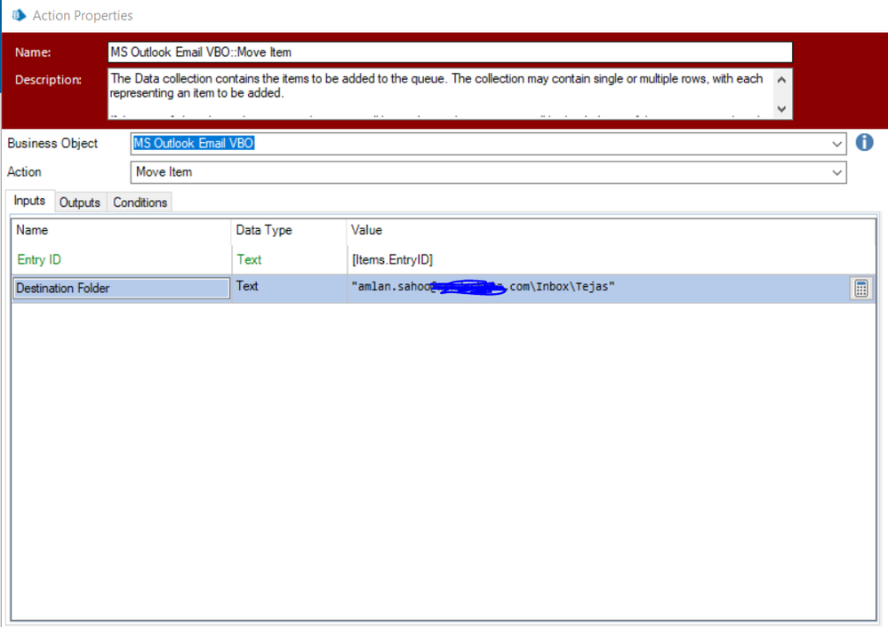

Hi, I have tested it's working fine for me. I have tested with the latest Outlook VBO from DX it's working for me for moving items.
PFA for the same,
Amlan Sahoo

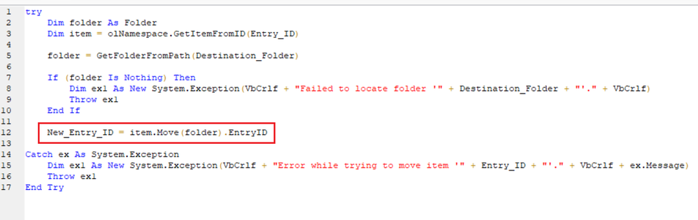

This is not an issue with the VBO. As you can see from the screenshot below, the code of the VBO performs a Move action on the Outlook API.
If a copy of the email is being retained in the original folder this is an issue with the configuration of the mailbox/Exchange. If you can't use Cached Exchange Mode you may be out of luck as it also controls synchronization of shared folders, which I imagine is what's happening here. You have so many emails in this inbox that Exchange can't keep up with synchronizing all changes.
What you might try doing, since moving an email generates an new Entry ID for it, is after the move try to delete the original email using the original Entry ID. This should, in theory, get rid of the email from the original inbox/folder but retain the newly moved email in the new destination folder.
