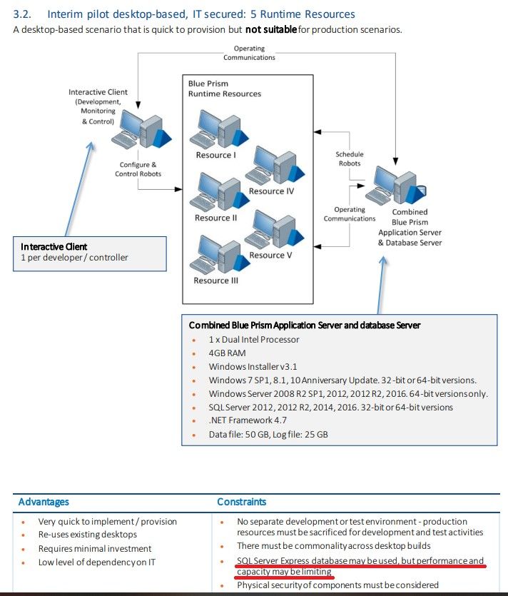

I have a DB-related question.
First of all, Is there a document that clearly states which databases can install a Blue Prism server?
Second of all, in the case of MS SQL Express, the document stated that there is a limitation of features in the free version.
Is there any evidence of any functional limitations to using it in a blue prism environment?
In the 5 RR environment configuration examples as shown below, the constraints are only guided as follows.
It is difficult to guide customers because it is not known exactly what the restrictions are.
Thanks in advance 🙂
