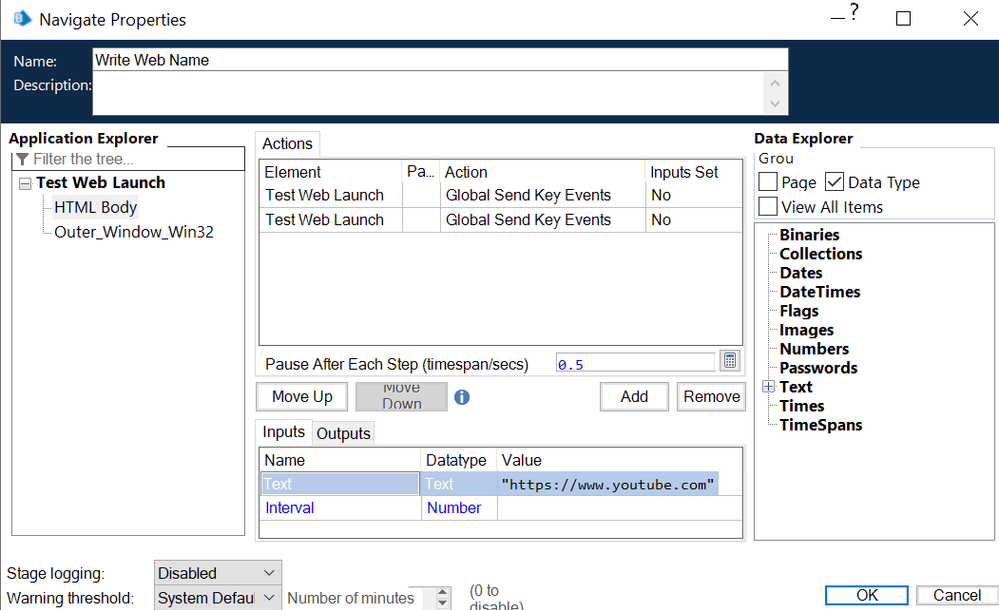

Hi Dilshad Khan - If you are trying to launch different websites in a single browser session - there are multiple ways to do so - please follow below steps:

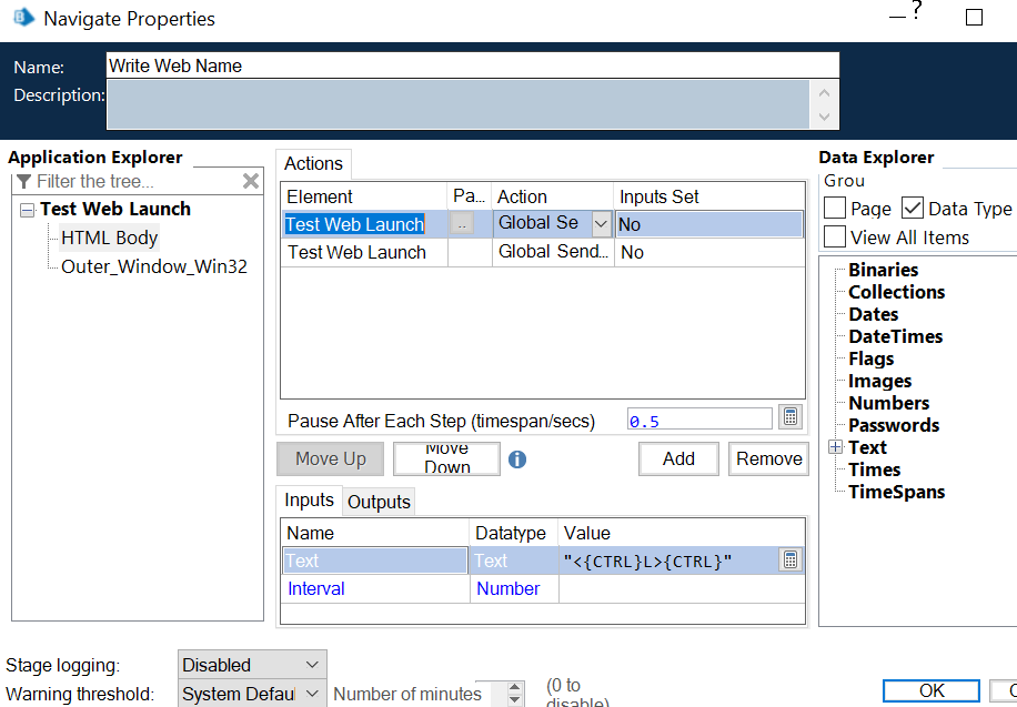

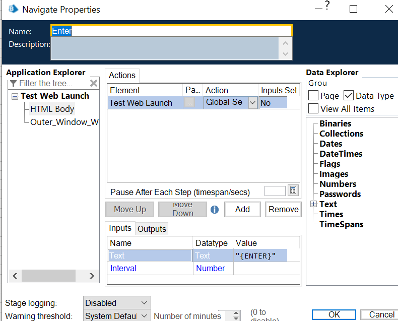

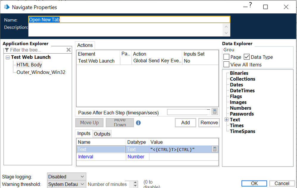

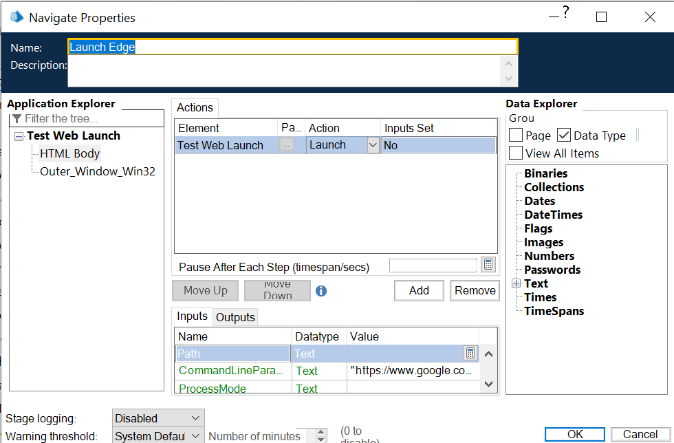

Use the as is launch option through navigate for first website, you can generate the tracking ID as well in Launch option - Output and once launched to open multiple tabs - You can either use Global send keys to do Control + T to open a new tab, Control+L to set at URL input and pass the URL path through global send keys then Hit Enter and the second way around is to use the Set Address option - Element spied having the ""Web Path/Xpath"" attribute = "/HTML[1]" as the value, use a Navigate and ""Set Address"" and pass the URL.
