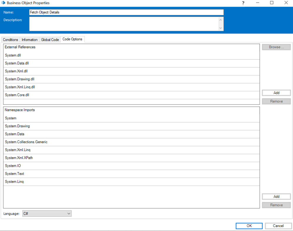

Add the following namespaces and external references as shown below:

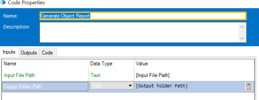

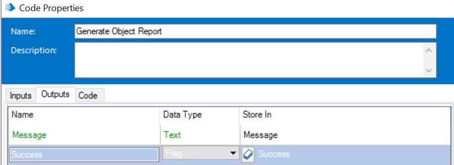

Now, you can add a code stage with the following parameters:
Code:

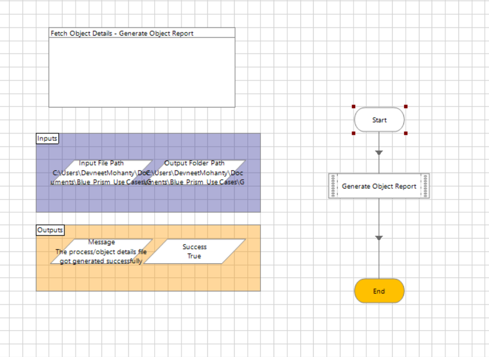

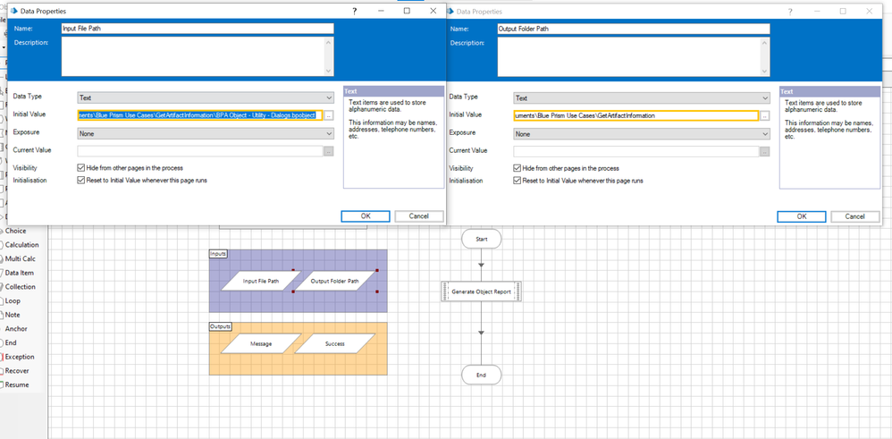

Once the workflow has been built, you can test the same with the provided bpobject or .xml file and an output folder path as shown below:
Test File:
Workflow:

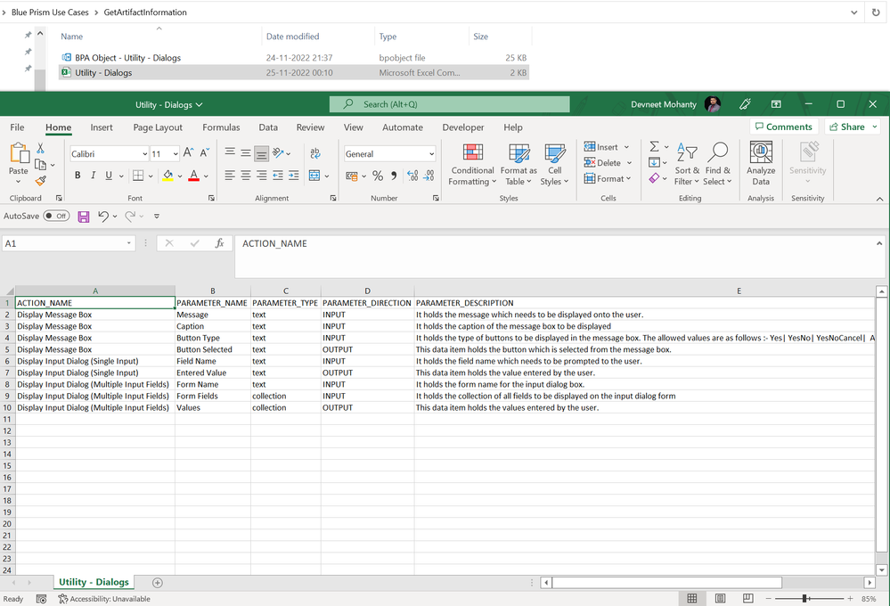

After Executing Workflow:
