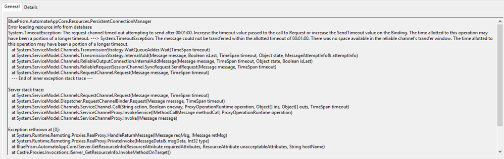

I am reaching out to seek your assistance regarding an abnormal behavior I am experiencing. All of my resources on a server lose connection with the AppServer randomly. They are unable to reconnect and several error messages appear in the logs.
The resources manage to reconnect to the application server on their own after a certain period (between 15 and 45 minutes).

Hello, do the features stop working while the automation is running or before it starts up?
Changing the BluePrism Login Agent service to start late may help.
However, you should also open a ticket with BluePrism support and provide as much information as possible.

Hi @Jrwork, thanks for your answer.
Features stop working for both cases, when an automation is running and when neither.
Yeah I should create a ticket.

Can you suggest what was reason of issue?
It seems that I have similar problem at few VDIs after upgrading to Windows 11. Before everything was working good. Also not all VDIs after upgrade has problem.

A little feedback after some discussions with the support.
They did not clearly identify the reason for this problem.
It may be a performance problem caused by the size of a certain table in the database, but I'm not convinced of the reason.
Furthermore, the problem hasn't recurred, so unfortunately there's no follow-up.
